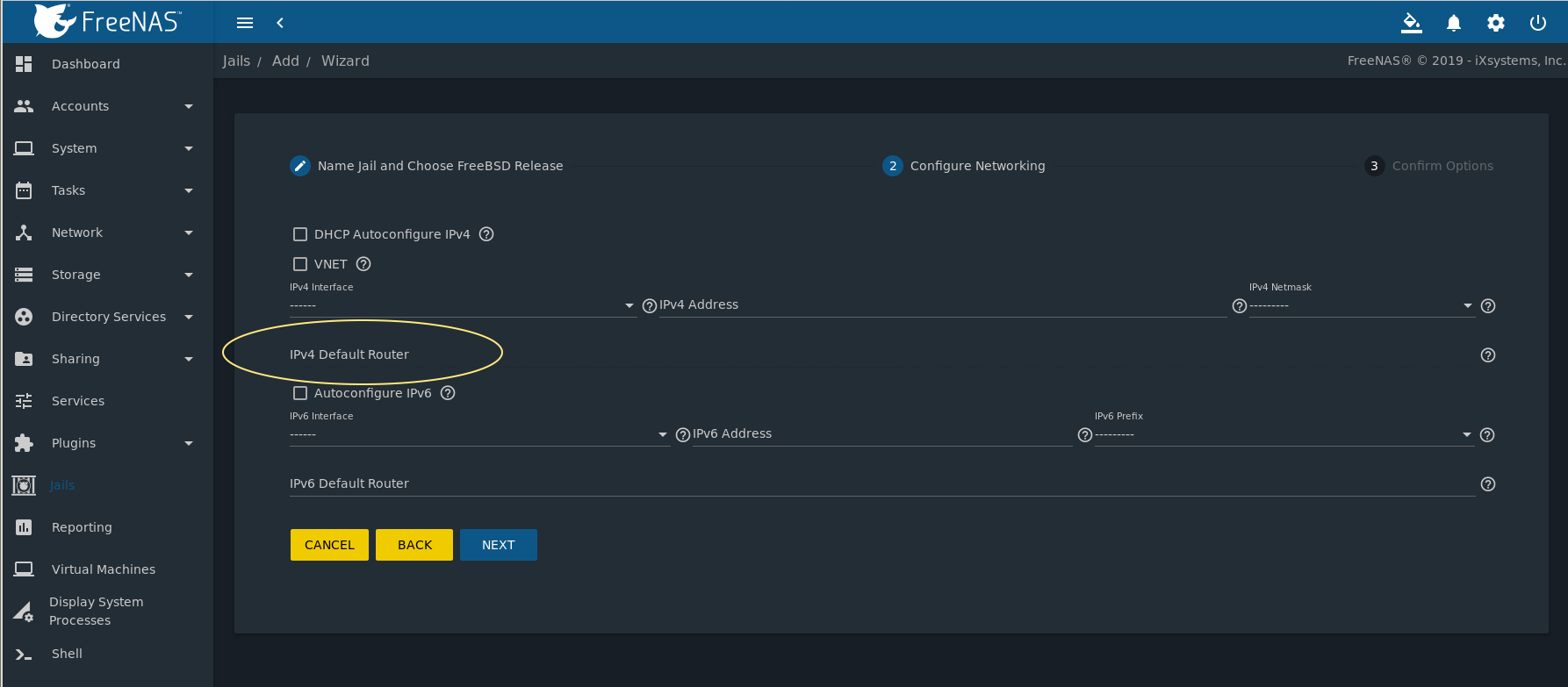

I have FreeNAS-11.2-U5 (updated from 11.2-U4). I've not created any jails or installed any plugins yet.
When I try to create a jail through the UI wizard, it results in the following:
Expanding the "More info" indicator reveals this:
FAILED
[('SSL routines', 'SSL3_GET_RECORD', 'decryption failed or bad record mac')]
Error: concurrent.futures.process._RemoteTraceback:
