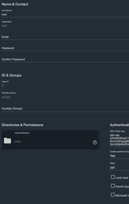

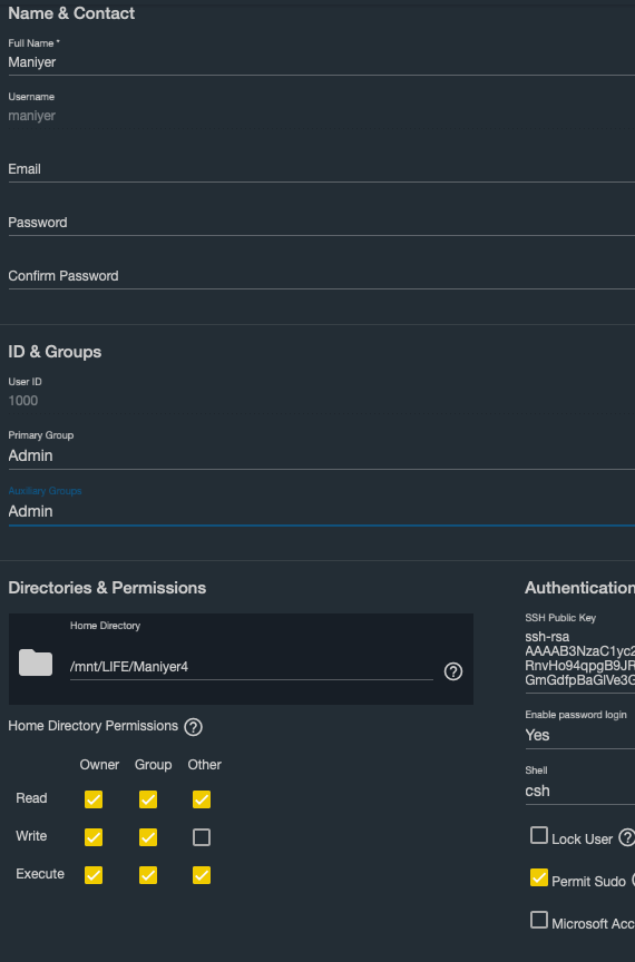

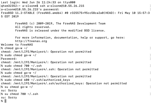

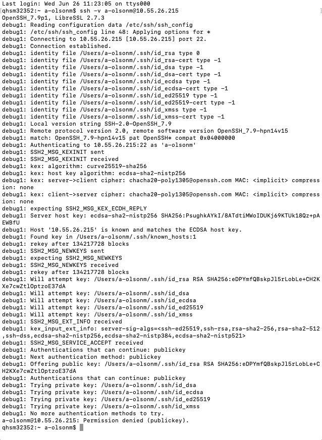

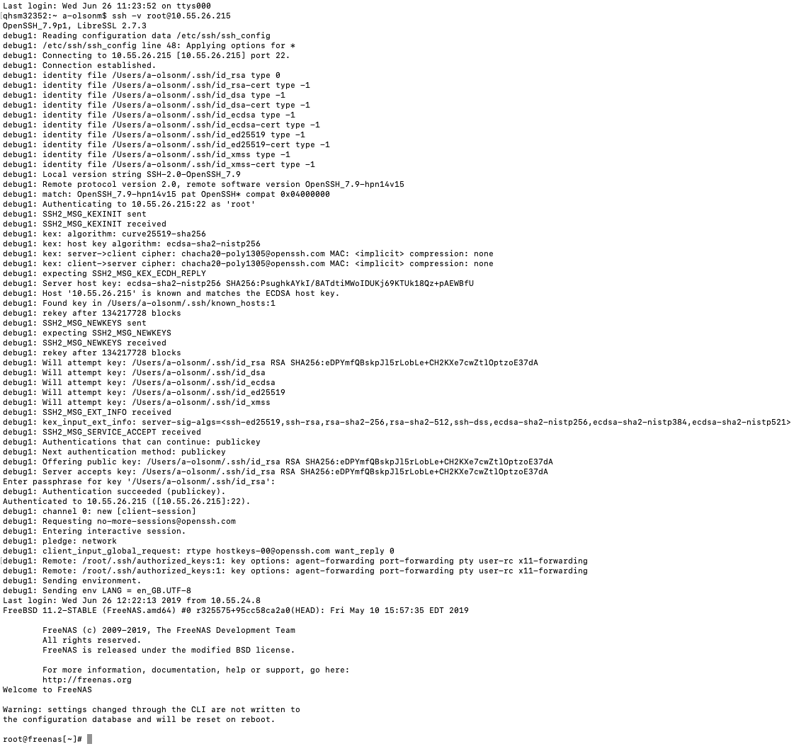

I'm trying to setup SSH on my FreeNAS setup but no mater what I do, I cannot get a user to login. Root is the only user that connects successfully. All other users get the 'permission denied (publickey)'.
I have tried everything from the following thread but I still can't get it to work: https://www.ixsystems.com/community/threads/freenas-11-ssh-permission-denied-publickey.59762/
I'm fairly new to FreeNAS, so not sure what I'm doing wrong. Please, I need clear step by step instructions because the previous thread above isn't very clear on where and what to do. I have attached the logs and user settings so you can see what I'm getting.
I'm on version 11.2-U4

auth.log is your friend, please check on server side!
anyway, I think you have bad permission... unflag Write for Group permission and try again with your key auth.

I agree I probably have bad permissions, but how do I fix them? I have un-flaged 'Write for Group' and saved it, but when I go back in, it's still flagged. I have also tried to create a brand new test user and the problem persists. auth.log reports 'Authentication refused: bad ownership or modes for file /mnt/LIFE/Maniyer4/.ssh/authorized_keys'

The "operation not permitted" errors tell me that the user's home directory is on a dataset with Windows permissions. Change that to Unix permissions and then you should be able to run the chmod commands to set the appropriate permissions, which is almost certainly what's going on.
