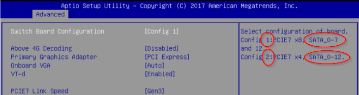

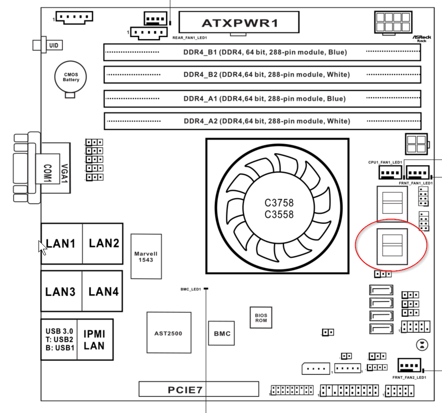

Caveat : Mini SAS HD Connector [SATA_8_11] and PCI speed 4x 8x
if you want this connector to work you need to be in switch board configuration "config2" in the section advanced / chipset configuration
Note : for BIOS firmware version P1.30 (17 may 2018) the default configuration is "config1" so the connector won't work
You have to choose between having this connector working or having a pci express port speed at x8.
If you want to go over 13 harddrives you must install a HBA card and they are all (as far as I read) 8x so you will have to go back into [config1] in the BIOS which will desactivate the SATA_8_11 connector.

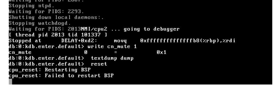

Freenas bug (?) : unknown cpu
extract from /var/log/message
Jul 13 00:40:00 freenas pmc: Unknown Intel CPU.
Jul 13 00:40:00 freenas hwpmc: SOFT/16/64/0x67<INT,USR,SYS,REA,WRI>
I don't see any effect other then this message

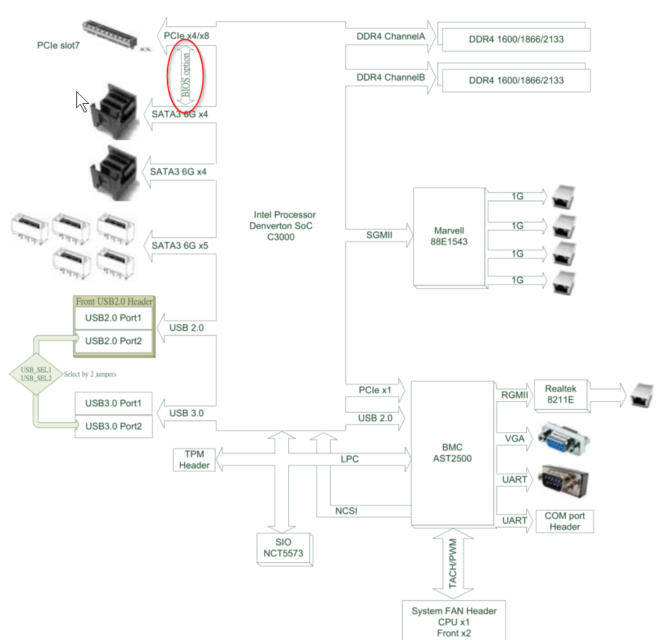

Bug Freenas or motherboard (?) : [USB3_2] connector disappear when connecting drives to the [SATA_8_11] connector
usb ports can be configured as follow
HARDWARE
- 3 usb keys 32gb usb3.0 in different brands (toshiba, samsung, sandisk) configured in triple mirror for boot
- 4 harddrives HGST sas 4GB connected with a mini SAS HD to mini SAS connector and a backpannel
DESCRIPTION
- when using the [SATA_8_11] connector freenas can not detect a usb key plugged in the [usb2] connector
- [USB_SEL_1] and [USB_SEL_2] jumpers are in position 2-3
- this supposed to means that the back usb connector [USB3_2] support usb3 only
- no problem when using the mina sas hd [SATA_0_3] connector
- [usb_1_2] connectors are not affected
