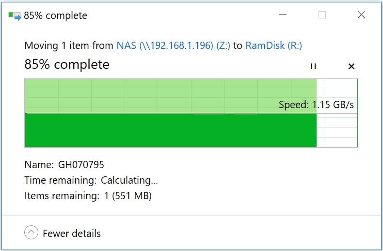

When copying a 4GB file from my NAS to my RAMDisk, I get full speed.

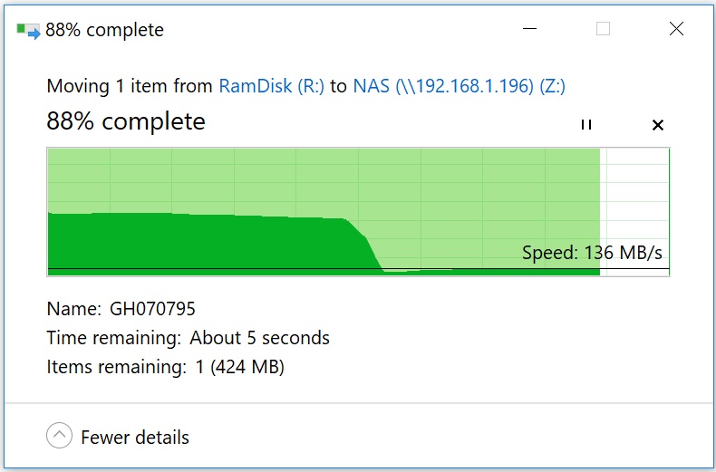

When copying the same 4GB file from my RAMDisk to my NAS, I get full speed until about halfway, then it drastically drops to 130ish MB/s.

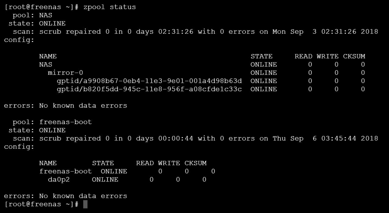

NAS Specs:
Intel(R) Xeon(R) CPU E5-1603 v3 @ 2.80GHz
16GB ECC RAM
2x4TB drives in mirrored mode

That's expect, first few GB are cached to RAM then you're limited by your pool performance, you'd need more disks or better yet some SSDs to get increased sustained write speeds.
Read I'm guessing is being done from the ARC, hence the speed.

Only a small part of total RAM is used to cache writes (10%?) it can likely be changed, and adding more RAM will also add to the cache since it's a percentage.
May 10, 2017
838
Sorry, can't help with that, but doubt that would be a good solution, possibly if you have a very specific use case where you only do small copies at a time, and then don't use the server until it finishes syncing to data to the pool, or else the more data there's to sync the slower the server would be while it's writing the data do the pool.
IMO best bet would be to use a VDEV with more devices, even with normal disks, a few of them in mirrors or RAIDZ can get you decent performance with 10GbE, my HDD pool now can only write @ around 400MB/s but it's because it's fairly full and likely fragmented, when it was new and IIRC it did around 800MB/s (possibly was 600MB/s, not sure) sustained writes.

The OS manages that dynamically based on what other resource requirements it has (and some memory leaks, in certain versions of 11.1).
If the reason for the throttling is due to insufficient RAM for the buffer, then there are a number of tunables, but it would be far better for the stability and safety of your system to just add some additional RAM first.

You can't expect to saturate a 10Gb link when your zpool is made up of 1 x mirror vdev of 4TB spinning drives.

1. If you want performance always go with mirrors and never RAIDZ. In theory your write performance doubles every vdev you add. Therefore based on the figures you have shown us (136MB/s write speed) add another vdev and get 272MB/s added another two vdevs on top of that and 544MB/s double that again 1088MB/s and your not far away from your 10Gb/s assuming you don't find another bottleneck somewhere else in the system.
2. Yes, SLOG only helps with sync writes.
3. More RAM is always good in the ZFS world in particular for read operations however write performance will often be defined by your zpool in the async world.

I'd hardly classify 4GB of writes as "bursty" myself.
There are tunables to modify the amount of dirty (and unprotected, if you're writing async) data but ultimately you'll still be limited by how fast you can spew data to disk.
