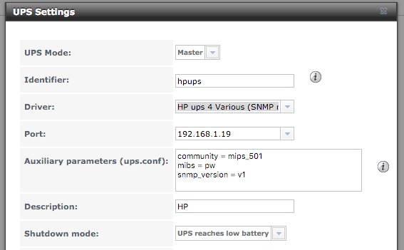

Hi everybody )
So... problem:
FreeNAS 9.3
Driver: HP ups 4 Various (SNMP mode) HP UPS Management Module (snmp-ups)
After start have following:
Jan 31 18:56:38 freenas2 notifier: Detected HP R3000 XR on host 192.168.1.19 (mib: pw 0.7)
Jan 31 18:56:41 freenas2 notifier: Network UPS Tools - UPS driver controller 2.7.3
Jan 31 18:56:41 freenas2 notifier: Starting nut.
Jan 31 18:56:41 freenas2 notifier: fopen /var/db/nut/upsd.pid: No such file or directory
Jan 31 18:56:41 freenas2 notifier: listening on 127.0.0.1 port 3493
Jan 31 18:56:41 freenas2 notifier: Connected to UPS [hpups]: snmp-ups-hpups
Jan 31 18:56:41 freenas2 notifier: /usr/local/etc/nut/cmdvartab not found - disabling descriptions
Jan 31 18:56:42 freenas2 notifier: Starting nut_upsmon.
Jan 31 18:56:42 freenas2 notifier: kill: No such process
Jan 31 18:56:42 freenas2 notifier: UPS: hpups (master) (power value 1)
Jan 31 18:56:42 freenas2 notifier: Using power down flag file /etc/nokillpower
Jan 31 18:56:42 freenas2 upsmon[19159]: Communications with UPS hpups lost
Jan 31 18:56:42 freenas2 notifier: Starting nut_upslog.
Jan 31 18:56:47 freenas2 upsmon[19159]: UPS hpups is unavailable
/var/db/nut
# ls
./ ../ snmp-ups-hpups= snmp-ups-hpups.pid upsd.pid upslog.pid upsmon.pid
# upsc hpups
ambient.temperature: 34.0
ambient.temperature.high: 55.00
ambient.temperature.low: 0.00
battery.charge: 100.00
battery.charger.status: resting
battery.runtime: 2369.00
battery.runtime.low: 180.00
battery.voltage: 130.00
device.mfr: Powerware Corporation
device.model: HP R3000 XR
device.serial: ID: YCDYJTJ51V , Msg: 192187-002

genai
Jan 28, 2016
As i understand, upsc takes data from UPS and then upsmon just perform necessary actions (shutdown e.t.c)
I think if SNMP communication is working (upcs see ups) - everything ok with driver, isn't it?
May be problem in communications inside NUT between upcs and upsmon? Or am i wrong?
