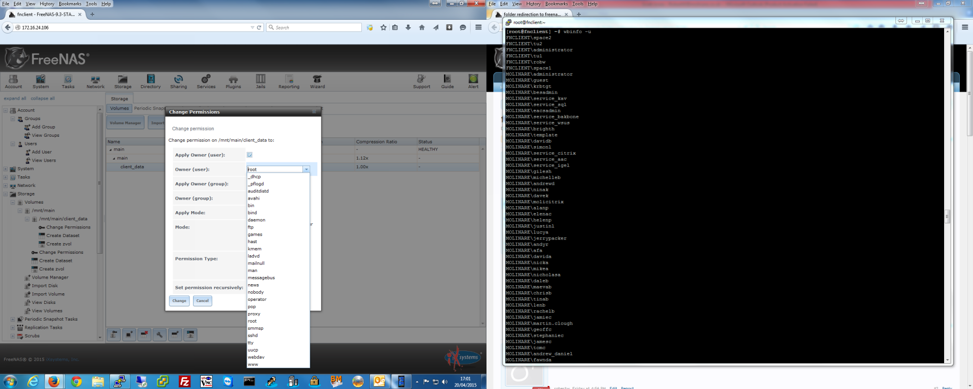

because when i get my freenas server to sync with AD it can look up users/groups but when i go into my dataset and want to change permissions to my owner to my domain administrator i cant, it doesnt show up (see screenshot)

That is because you need to make the modifications in the windows security tab for the share.

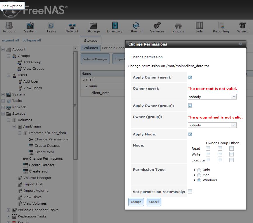

but i cant even log in the share using windows explorer, it wont let me log in, even as the root user
i cant set the dataset permissions to a local administrator using the freenas web gui

success i have done it!
i added a new user account (administrator) via the freenas webgui and made it the new dataset owner and i made a CIFS share for the new dataset
i added the domain users (tu1) (tu2) to the freenas webgui, the user accounts must be the same username/password they use to log into the domain
i then logged in to a windows machine as administrator and accessed the cifs share via windows explorer, i then made 2 subfolders tu1 and tu2 and then went in both sub folder properties deleted everyone and added the respective user to their subfolder
also in everyones subfolder i had to add 2 other sub folders, Desktop and My Documents, if i didnt it wouldnt work
