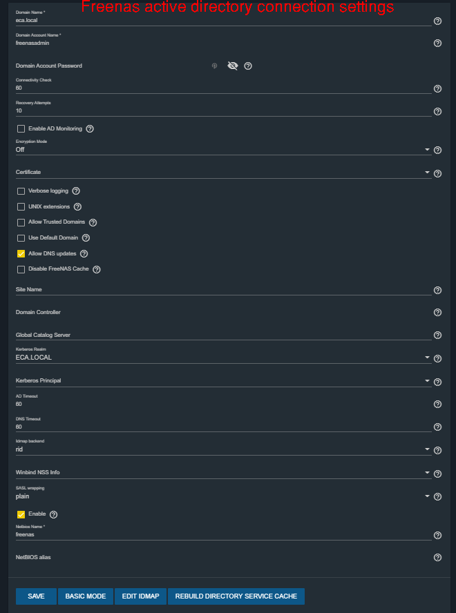

Freenas settings i have is the following pictures:
Freenas AD setting to connect to Server 2019 AD:

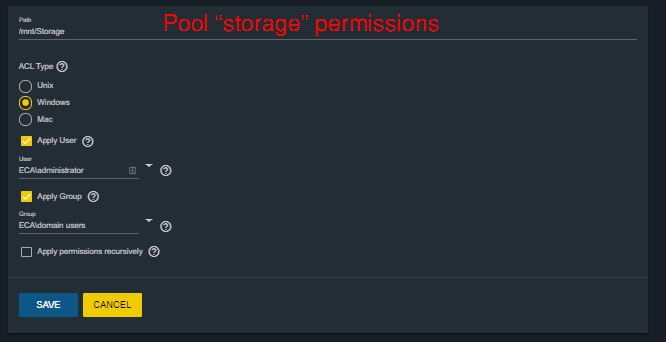

Pool permissions:

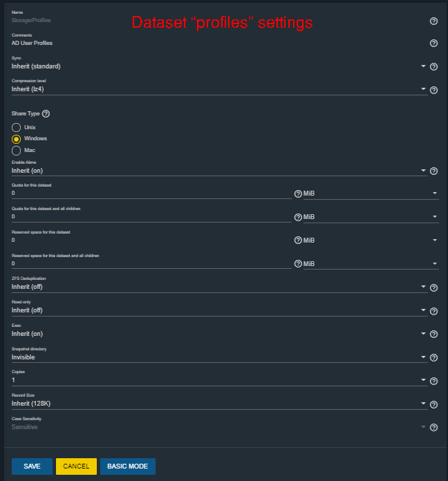

"profiles" Dataset settings:

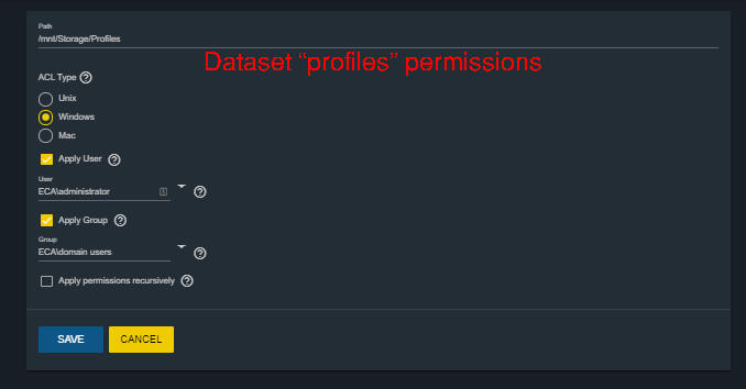

"profiles" Dataset permissions:

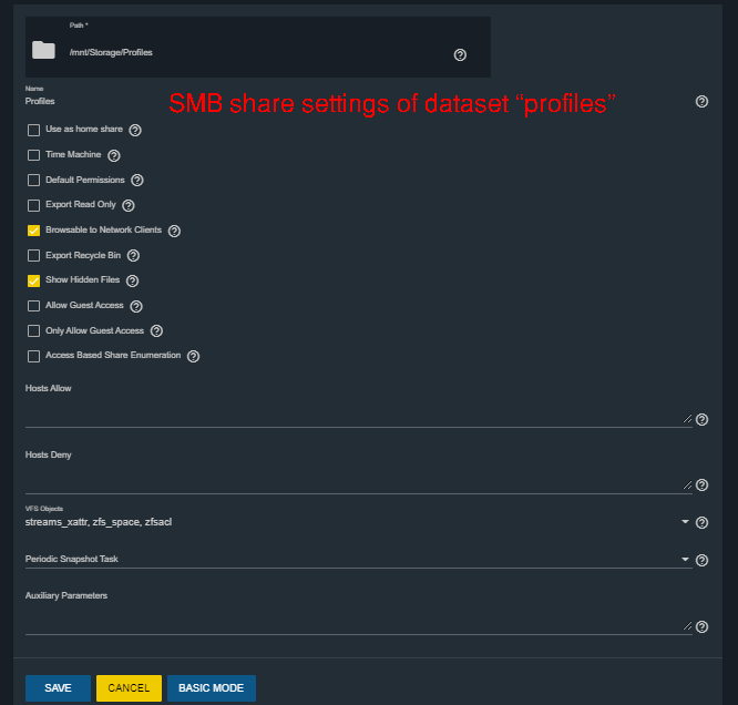

"profiles" SMB share settings:

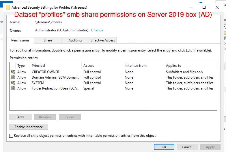

On the windows server 2016;
I have the following permissions setup as per microsofts guide linked above
this is for the smb "profiles" share from freenas

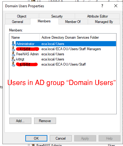

FYI - Users in the "Domain Users" group.

If for example the permissions on the windows server is set as per MS recommendations for Folder redirections. as this link
on the Dataset- \\Freenas\Profiles\
Use the following settings for NTFS Permissions set within explorer on windows server:
  • CREATOR OWNER - Full Control (Apply onto: Subfolders and Files Only)
  • System - Full Control (Apply onto: This Folder, Subfolders and Files)
  • Domain Admins (group) - Full Control (Apply onto: This Folder, Subfolders and Files)
  • Administrator (user) - Full Control (Apply onto: This Folder, Subfolders and Files)
  • Folder Redirection Users (group) - Special - Create Folder/Append Data + List Folder/Read Data +Read Attributes +Traverse Folder/Execute File (Apply onto: This Folder Only)
What is the nfs4:mode and commands needed on freenas. for this "profiles" data share?
What is the user/group permissions. for this "profiles" dataset?

Sharing>SMB shares
/mnt/Storage/Profiles
TICK- Browsable to Network Clients
TICK- Show Hidden Files
VFS = Streams_xattr, zfs_space, zfsacl
Services>SMB
default settings
added "nfs4:mode = Simple" to auxiliary parameters (then shell command "kill -HUP <pid>" pid of winbindd
Pool
permissions for mnt/Storage
ACL windows.
apply user tick = ECA/Administrator
apply group tick = ECA/domain admins
dataset
permissions for mnt/storage/profiles
ACL windows.
For windows server permissions on Profile share etc.
Following MS settings from here (https://docs.microsoft.com/en-us/windows-server/storage/folder-redirection/deploy-folder-redirection).
i got the following.
Client PC thinks its connected to the share, because profile folders directs correctly. but no files show up when view from server admin account?
