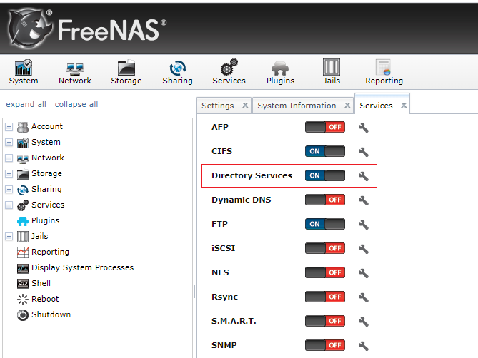

jucelio_rosa
Jan 11, 2020
15
Good afternoon.
The problem was already solved.
First I tried to follow the steps you indicated, but to no avail.
So I was instructed to check if AD is working well, if AD Sync was working well and then try again to enable the service.
