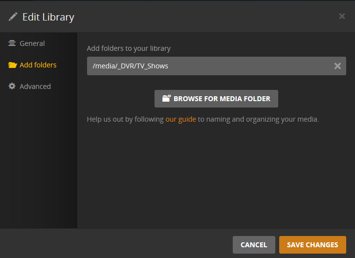

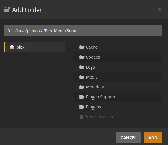

My last issue is that I cannot add via browse for share. All I see is PLEX, I used to have a MEDIA folder I could browse. "Noshare" screenshot.
If I manually type in the path to the shared folder (under ADD FOLDERS TO YOUR LIBRARY) where my media resides, then it will find it and scan it correctly. "Addmanual" screenshot.
Not a huge issue, but previously I could just browse to the folder I wanted to add.

The issue about browsing for media folders from within Plex is simply that Plex expects the root for media to be a particular folder. If you choose to put your media mounts elsewhere, then browsing won't help you. In that case, you just type them in.
No big deal, but it is a little disconcerting to a first time user who may not be aware of this. But then, that's why we have the forums :)
