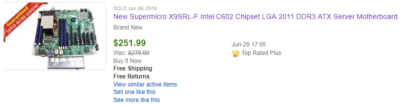

my understanding is that I'll be giving up a fair amount of power efficiency.
It might be a little different, but that depends more on what model CPU you select.
What (else) would I be giving up, and do you think an X9 build would last me for 5 years?
I picked one up like this, just a few months ago:
If you keep an eye out, you can find one like it and I certainly expect it to last 5 years or more. Where I work, I manage many servers that are approaching 10 years of age and we even have a couple still running that are 12 years old. If you configure them with quality parts and don't mess with them, they just sit there and run.
I'm a bit worried given that it's already 5+ years old.
I wouldn't be so cavalier with machanical parts like the drives. Get new hard drives if you can because 5 years is about the life expectancy for them, but it is different with non-moving parts. Server components are made much better and I see them last the full life of the system with no difficulty at all and, like I said, we have a server farm at work with many systems that have not been funded for replacement yet. The place I work moves with glacial slowness.

All right, I'm sold on the X9SRL-F then, and I'll probably get a Xeon 2690 v2 for it. And to clarify one more time - I don't need the memory for the transcoding or nas, I need it for my other needs.
