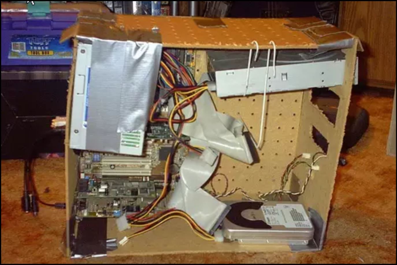

I plan to just find a large enough cheap box that can mount several drives with fans. I may even screw the drives to some external metal plate and run the cables out of the case.
Real computers don't have covers :)
Like this?
Seriously, sometimes covers are needed to get proper airflow over the drives and other components.
The drive temperatures go up quickly if I run my 48bay server with the cover off the drive bay.
What ever case you choose, it needs to have great airflow over the drives to keep them in the vicinity of 35 °C.
This Fractal design case is a popular option :
https://www.neweggbusiness.com/product/product.aspx?item=9b-11-352-051

That was just a joke we used to say years ago.
The case referenced looks interesting. And almost affordable.
I get it. That is why I posted the photo. I think it is hilarious.
