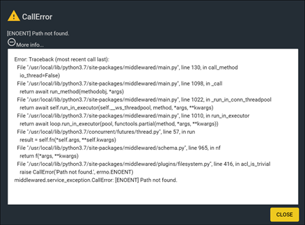

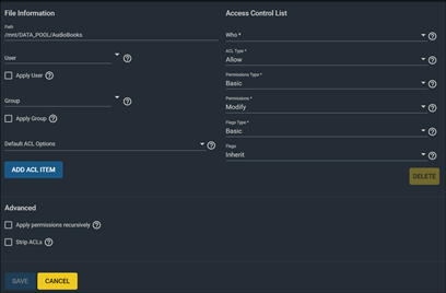

On any of the datasets on the backup system if you Edit ACL you get the following error:
And the ACL's on backup system dataset's are empty.
