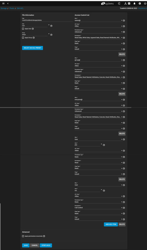

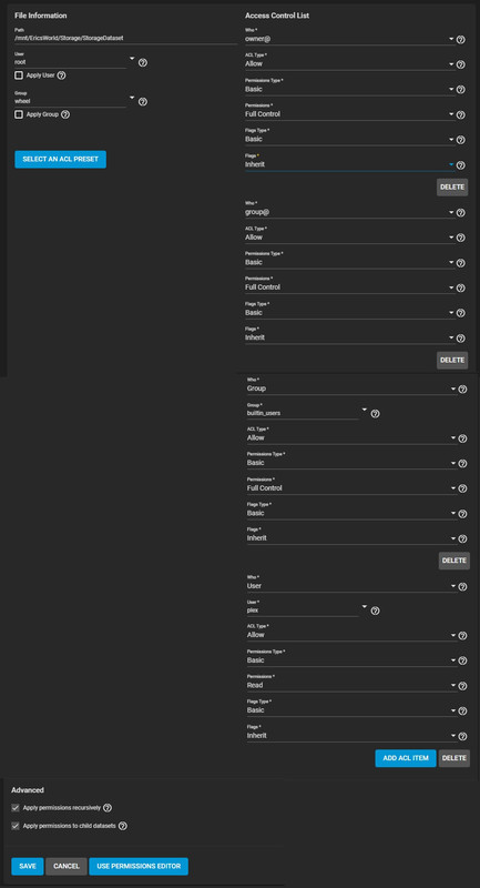

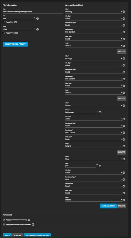

1) Create a dataset for MyData/Storage
2) Create any desired child datasets of MyData/Storage
3) Create a local user "plex" with user ID (972) (IIRC this is plex's UID, you can double-check) *note this isn't required, but eases management
4) recursively set ACL (with traverse checked) on MyData/Storage with the following entries:
owner@ - FULL_CONTROL
group@ - FULL_CONTROL
GROUP:builtin_users - FULL_CONTROL
USER:plex - READ
All should be set to INHERIT
This will allow the plex process running in the jail always be able to read any data written to the server (via plex entry), and all local users to read / write data on server (builtin_users).

OK.. so yes the Asus is a bit more of a problem, in the end I just settled for using it as an AP. Getting back to the Plex/TrueNAS.. I think I've done as asked (but I'm a bit noob) and either I've done it wrong or it hasn't worked.. Afterwards I even restarted Plex, but still no good.. I tried deleting that newly created Dataset and using the 'Permissions' directly for the 'Storage - Default storage entry' again still no go?

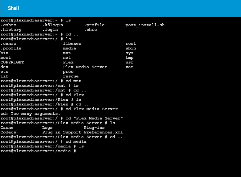

Running the jail shell (and not knowing much about linux) I typed 'whoami' which gave me 'root'. Which is correct I guess, but what I don't understand is, once I created the user 'plex' how that user gets associated to Plex related tasks? Is it purely on the guid?
In my head the plex jail shell should be running as 'plex' user? and if it's not (which it is't) when root user itself attempts to access the /mnt/MyData/Storage/ it see's no directories further than /mnt ??

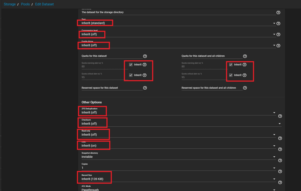

Ultimately, I was told "All should be set to INHERIT" which you can see isn't the case but I'm almost certain that I set that originally, now looking back into it to edit it, which boxes should be set to 'inherit' (all of them??)
https://i.postimg.cc/zX1XdL20/Inherit.jpg

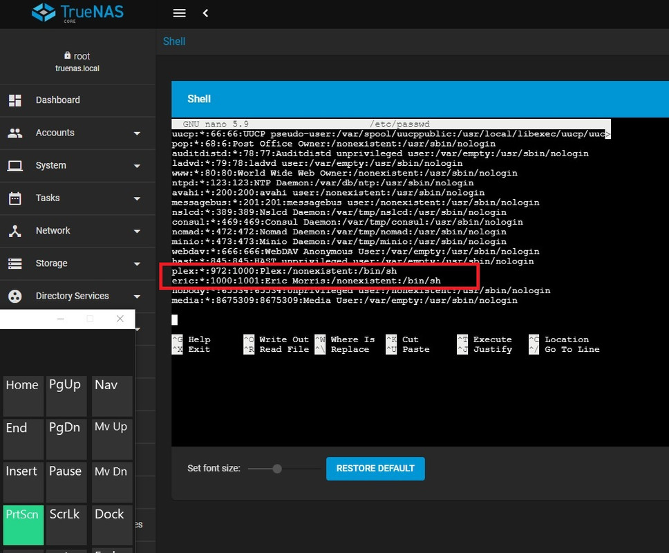

I seem to recall that in /etc/passwd you should be able to confirm that the uid for the plex user is 972
Check that first
Then create that user in TN Core and give it access to all the media data
Then in jails, create a mount point to the media data.
But first confirm the 972

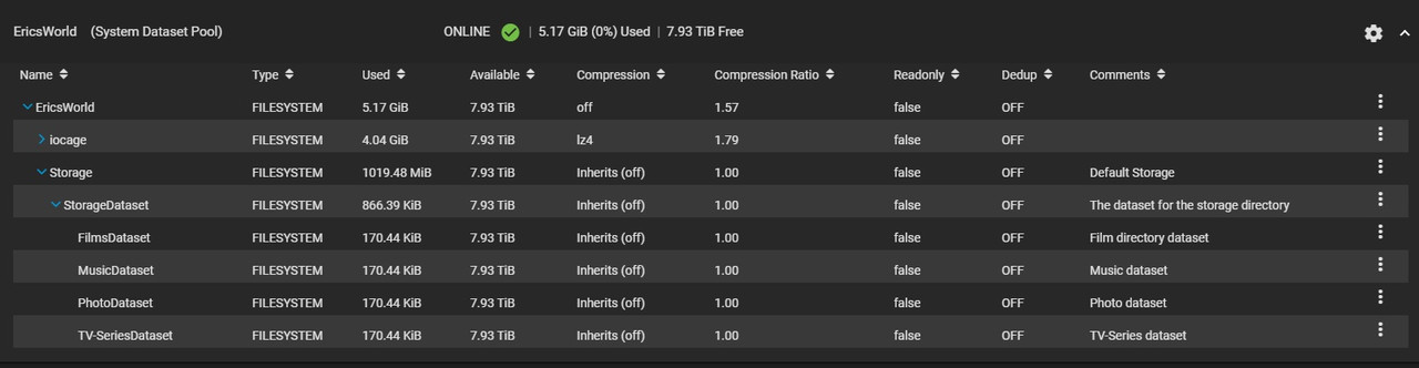

However, now I'm back to the Plex task in hand.. I've reinstalled TureNAS and learned a thing or two during that process, namely that by creating a 'Dataset' I don't physically create the directories myself. Noob I am, yes and, no doubt making things harder for myself from the start!

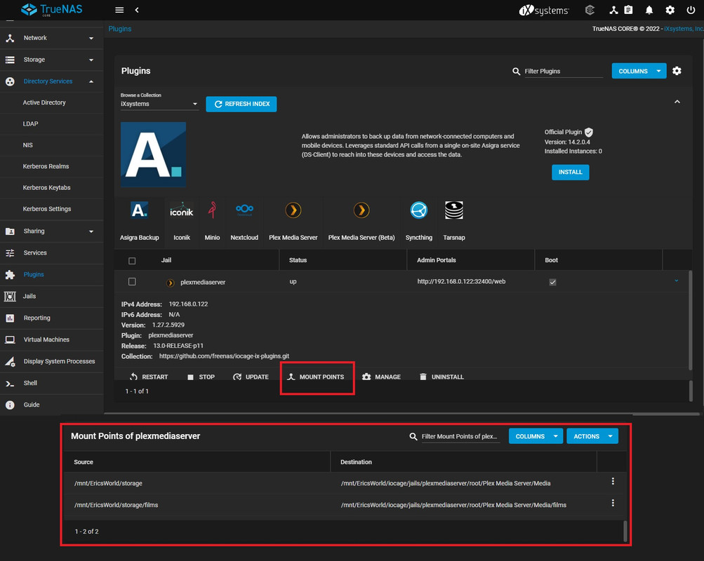

Then as you've rightly mentioned @NugentS "Creating a mount point" which I had never done before.. again my noob apologies.
So I'm starting to get there but not quite there yet..

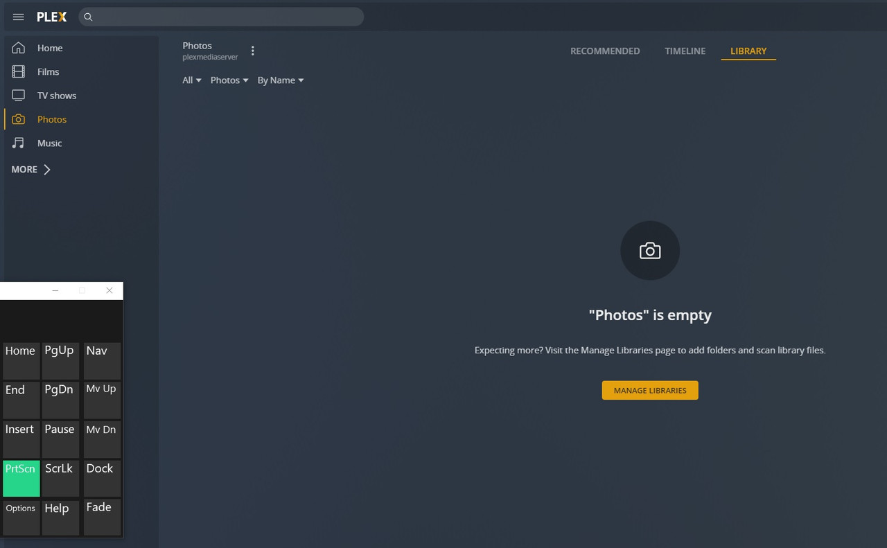

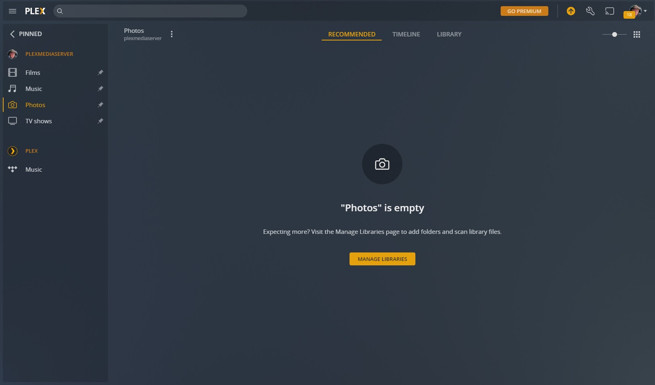

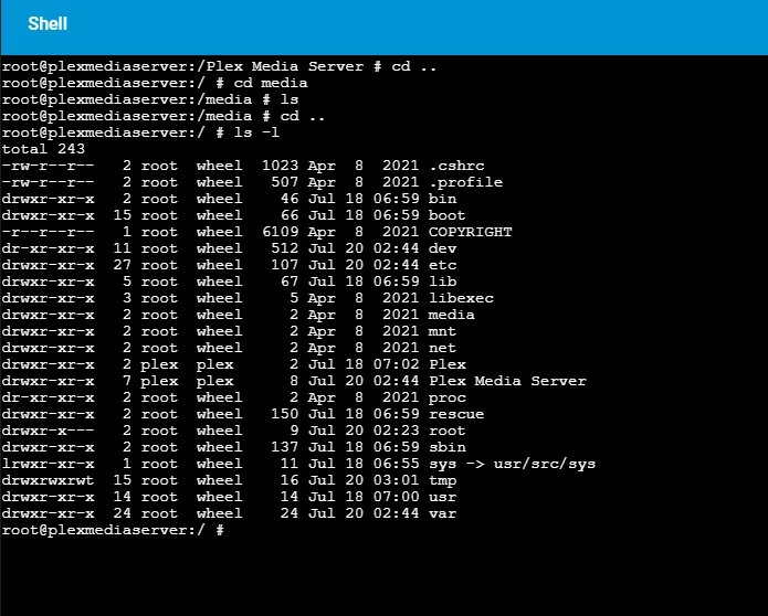

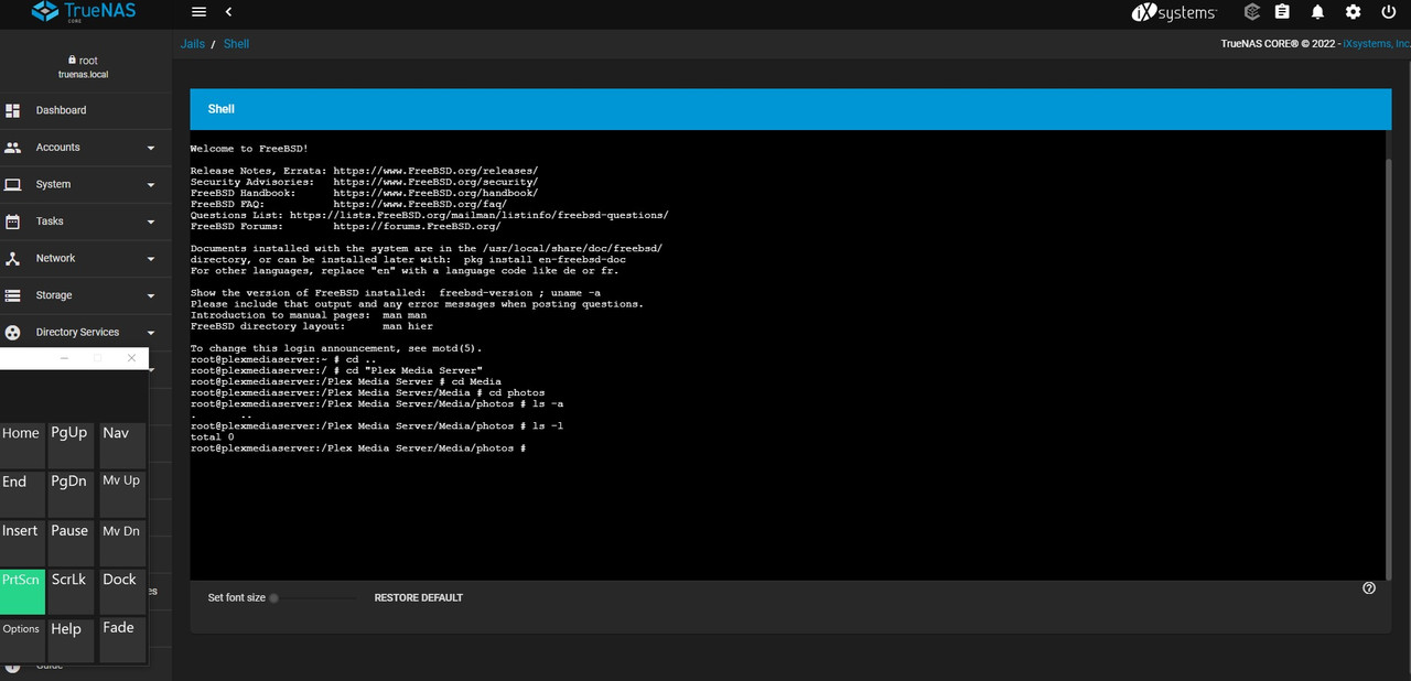

https://i.postimg.cc/nhRMshbc/Plex-Jail-Shell-Sees-No-Files.jpg

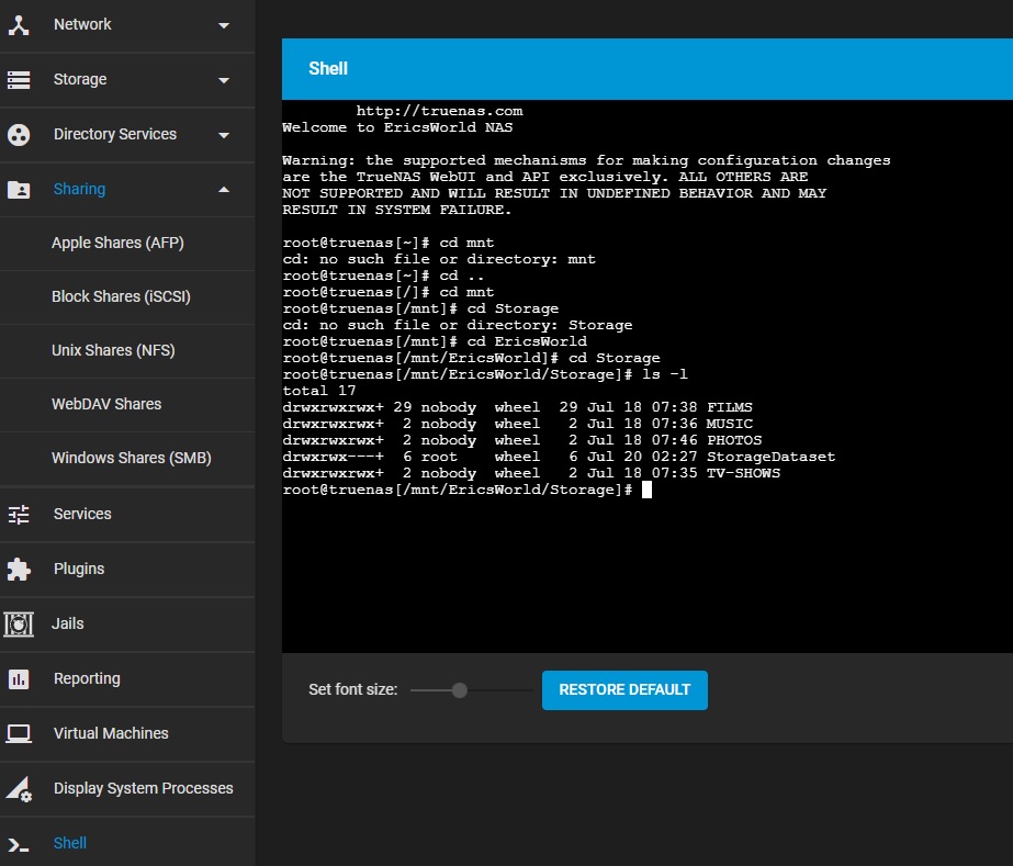

https://i.postimg.cc/sxr2FBSK/True-NASShell-Sees-All.jpg

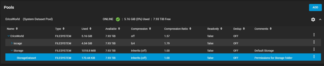

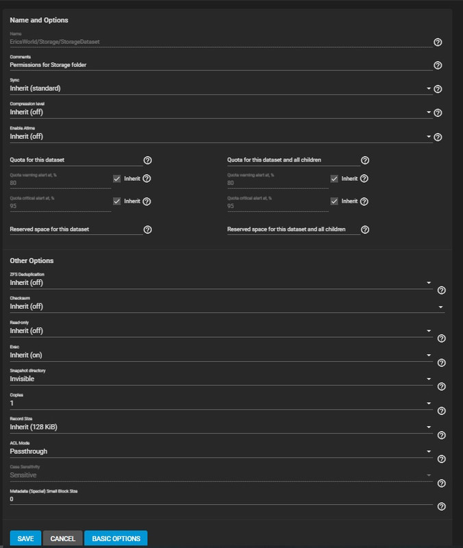

https://i.postimg.cc/YSv0QBMN/Storage-Pools.jpg
https://i.postimg.cc/jjB5X3Sp/Storage-Folder-Permissions.jpg
https://i.postimg.cc/gJR0Bywn/Plugin-Mount-Points.jpg
https://i.postimg.cc/Wb7dv75Z/Photos-Is-Empty.jpg

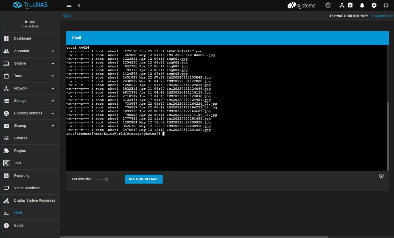

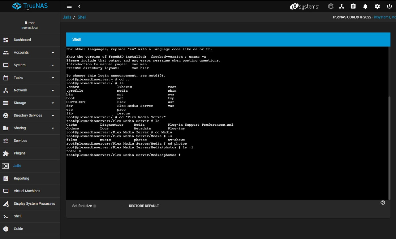

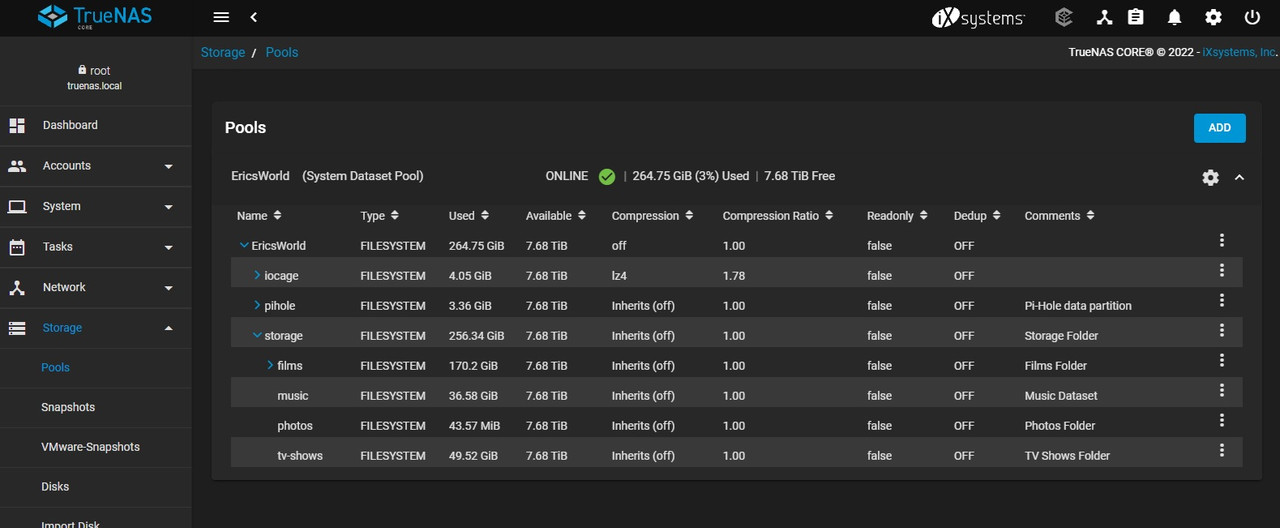

I'll attach several screenshots of where exactly I'm at now.. Obviously, my father (eric) needs to be able to upload data to the storage volumes with full access permissions (hence the user eric was created) and plex user needs to also read those files. However, what I'm not sure about is what the actual owner should be once they've been uploaded (root?) so in the mean time I've been running this command:
chown -R root /mnt/EricsWorld/storage/
Nearly there, just maybe a mount point issue or more likely a permission/ownership issue.
Really appreciate you help and guidance please, thank-you in advance..

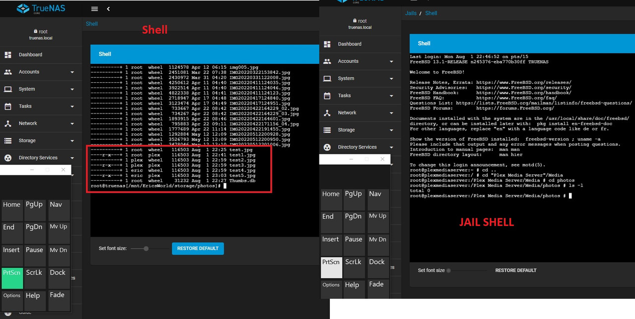

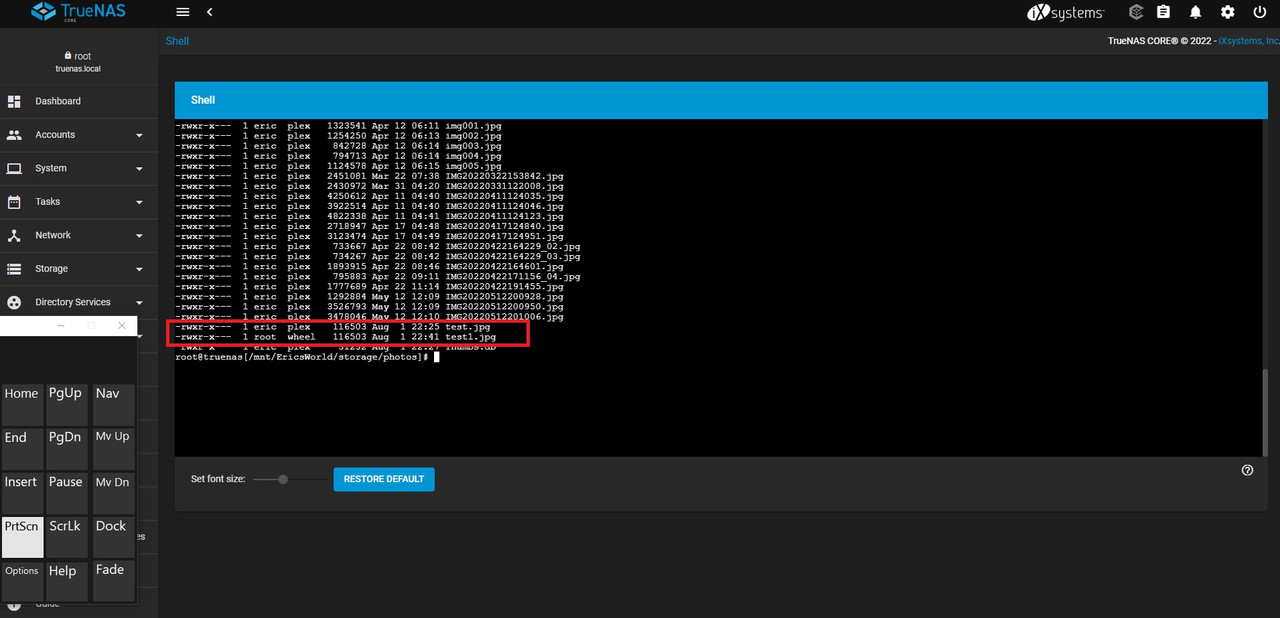

Sorry, you had already asked me that before and I forgot to answer you. Yes plex 'user' is set to 972, eric 'user' is set to 1000 and 'eric' is a member of the 'plex' group as well..
https://i.postimg.cc/rwh0FRHp/uids.jpg

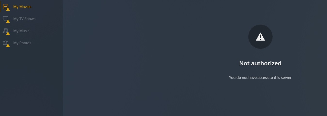

I'm using 'ls -l' in the root shell and trying to figure out what the file permissions are supposed to be to show up in the plex jail shell, then I presume the media files will magically start appearing?
https://i.postimg.cc/GmSpkJKW/Experiment.jpg
https://i.postimg.cc/QxmCMrTx/Exp2.jpg
https://i.postimg.cc/CxK1B6GC/Exp3.jpg

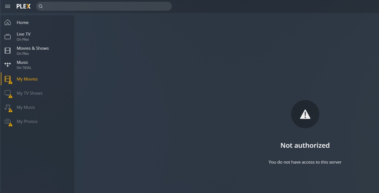

EDIT.. Or not.. o_O
https://i.postimg.cc/PfgVqPDT/New1.jpg
I'm really struggling to get my head around all this.. so does that mean it's not an ownership/group issue? :eek: My brain is fried..
