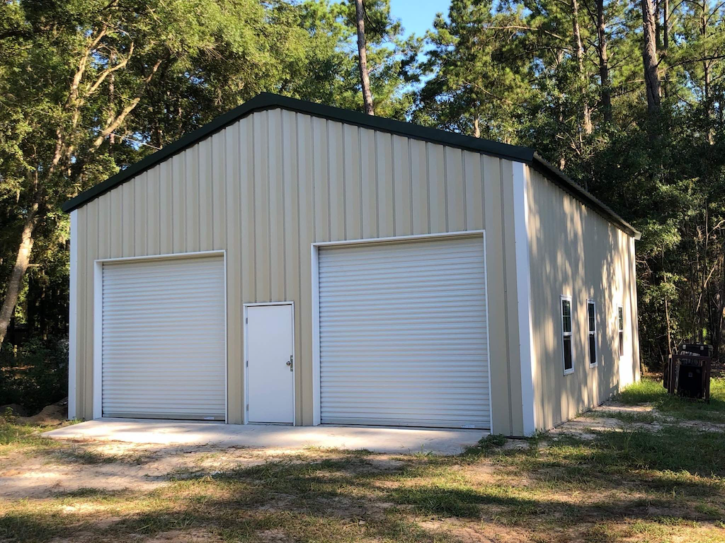

There's no construction loan, I'm paying cash--so budget is a factor. Not sure I see a benefit in LAGging two lines together, but the cost delta to run a second line (as backup in case one gets damaged, or for future expansion) shouldn't be very much...
Is there anything special I should look for in the cable itself? Even though it would be in conduit, it would still be outdoors, which often imposes requirements for jacketing material and such.
You should look into getting an armored fiber patch cable.
A good option would be: http://www.fs.com/products/41033.html They will do custom lengths, don't be dissuaded by the default lengths.

Well, surprise surprise, the project's taking longer than expected. It isn't finished yet, but it's getting there:
I just ordered the cable from lanshack.com; the electrician has been busy getting the new panel installed.
15,504
...and finally, almost a year after the question, the server rack is moved out there. Noise and heat level in my study have dropped considerably (not completely; the 5524 has a fan that's still running), the network connection is working fine, and now there's air conditioning in the server room--meaning the disks are much cooler (about 10 deg C across the board). Good deal all around.
