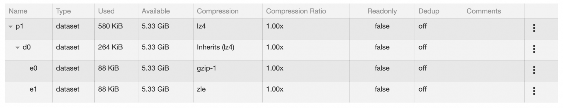

Shouldn't I still retain the ability to customise the compression (and other ZFS options) sharing the entire "root" of the dataset instead of the single datasets on their own?
Maybe I didn't explain myself that well in the first place. On my attached screenshot ( Screenshot 2018-11-22 at 21.30.11.png ) you can see d0, e0 and e1 and everyone of them has a different compression (I'm just toying); what I was asking is: creating a SMB share of d0 is any different from creating two different SMB shares of e0 and e1?
