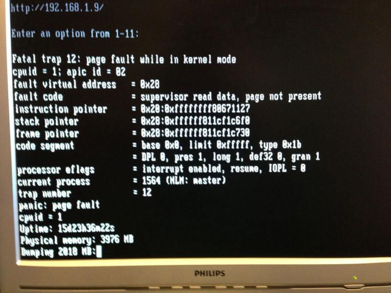

The error happens at random intervals. Sometimes few times a week, sometimes once a month.
Build: FreeNAS-8.2.0-RELEASE-p1-x64 (r11950)
Platform: Intel(R) Core(TM) i5-3550 CPU @ 3.30GHz
Memory: 3976MB
Screenshot of the error attached:

First thing I'd try is more memory. Faults of your type are almost always hardware failures or incompatibilities in the hardware with FreeBSD. You could also check to see if your motherboard BIOS is up to date.
Other than that, you're options really are limited except to start troubleshooting things until you find something broken.

Fatal trap 12 is a known issue with 8.2.X.. I was seeing it when access shares on NFS.. Upgrade to 8.3.0

I am also experiencing this issue and I am running 8.3.0. It happens completely randomly as the last poster said, sometimes it will happen every day, sometimes it will run for weeks without issue.
I am currently running freenas on:
Build FreeNAS-8.3.0-RELEASE-x64 (r12701M)
Platform AMD E-350 Processor
Memory 8125MB
