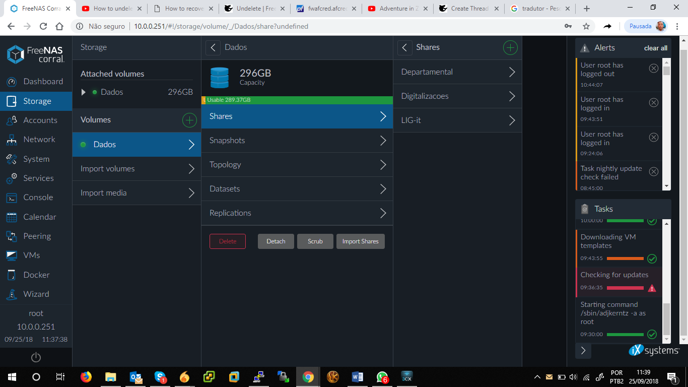

I had a problem creating a share in FreeNAS Corral. My structure focuses on two main folders and their subdirectories. When I created the share, it copied the data from the central folder and by accident, I deleted that copy, affecting my original files.
How can I recover this data?

Do you have snapshots setup?

Well, there's your problem. Corral has been dead and buried for a year and a half now. Literally nobody on earth wants to support Corral (I stand by this - if anyone wishes to prove me wrong and support Corral, PM me and I'll buy you a beer after I'm satisfied that the support is real). Time to dust off the old Resource: https://forums.freenas.org/index.ph...ng-from-freenas-corral-to-freenas-9-10-11.36/
Ok, this isn't a Corral issue per se, but you're making things a lot more difficult for everyone by using Corral. Unfortunately, you're still out of luck if you deleted data and don't have snapshots (or if you deleted entire datasets).
