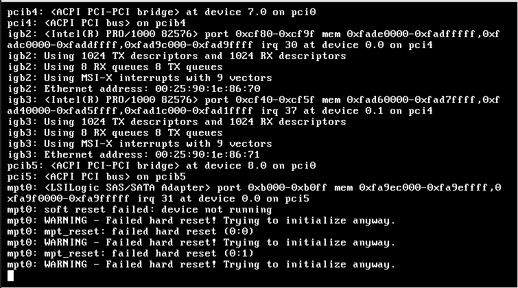

Now here is where I run into problems. When booting TrueNAS, it gets stuck here attempting to (I think?) reset the RAID card.
Does anyone know how to fix this? I tried booting a generic FreeBSD install disk to see if this was TrueNAS specific, and it also seems to get stuck with the exact same thing.
Any ideas on how I might fix this? My random guess would be the particular firmware that distro loads isn't FreeBSD compatible, but I honestly have no idea. I can provide additional details if necessary. Thanks!
