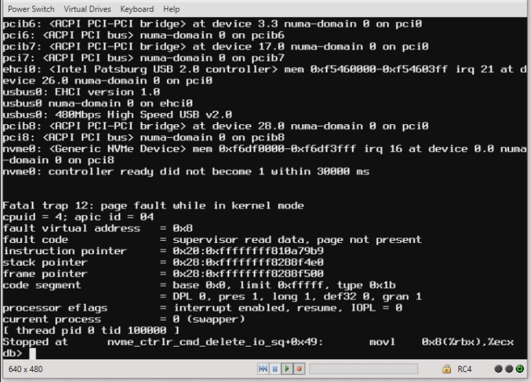

Last Sunday, our Production FreeNAS server (HP DL380e G8, 96GB RAM, boots off tiny mirrored boot M.2 SSD's, main pool is Seagate Exos 10Tb x12 in 4 sets of 3-way mirrors + mirrored 240Gb NVMe w/ power loss protection + ARC2 single 500Gb M.2 SATA Crucial w/ power loss protection) crashed. The symptoms is that it seemingly stops processing iSCSI (Sync=Always, out of paranoia...) traffic for our ESXi hosts. The local console is responsive, but the WebGUI is slow at best until it becomes completely unresponsive. At this point the only option we have is to *try* to reboot via the local console menu and if that doesn't work, press-and-hold the power button... Last Sunday was the 2nd or 3rd time this has happened, with the exception that the server would not reboot afterwards with the following error mentioning the NVMe drives.
Unlike non-booting SATA & SAS drives, NVMe's seem to have a dangerous ability to crash a system on a whim via Kernel Panics, MNI's, and/or BSOD (and the like). For example, I have a brand new WD 500Gb Black NVMe drive, and it crashes a Windows server just trying to format the device, just like it's predecessor 250Gb version did...
I got onsite, powered off the server, and removed both NVMe drives. Afterwards, the system would boot but would NOT mount the main pool. I put the NVMe pair back in and the system DID boot and attach the main pool (maybe the complete power off helped, who knows...):

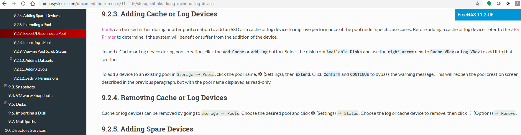

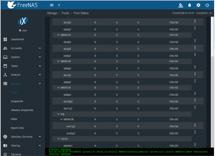

I tried to remove the entire SLOG NVMe pair, but as the screenshot above shows, there's no option to do that. The online manual (https://www.ixsystems.com/documentation/freenas/11.2-U6/storage.html#removing-cache-or-log-devices) says that removing devices from SLOG is supposed to be possible...
...but when I tried to removed either "nvd1p2" or "nvd0p2", I just got this error saying "Disk could not be removed" & "operation not supported on this type of pool". I tried to Google the error, but found nothing modern. I tried offlining the drive, then removing it, same result.
WeTYjcg7u7XJk4-u2nZQFCnkKYswmW_gDMGnyidjUi3C4DqQ5bz0bWriBfjFo8QZBIy2CgxKmjI5u3pdNSGJsYfjvylnVS8dWzijwH9mff5UFOLQm6Q9nNNxER7Kr0UgM_CaLsxE
So FreeNAS won't let me remove the NVMe's, but I can't risk another random crash either. Very weird and concerning especially since the previous FreeNAS (albeit older software, lower hardware, and slightly different config) has been rock-solid for years of straight use. Earlier that day, I received (bought for a completely unrelated purpose) a pair of Kingston 500GB A2000 M.2 2280 Nvme Internal SSD PCIe Up to 2000MB/S with Full Security Suite SA2000M8/500G drives. I know these are not ideal SLOG drives, but I had no choice to use them to replace the previous MyDigitalSSD 240GB (256GB) BPX 80mm (2280) M.2 PCI Express 3.0 x4 (PCIe Gen3 x4) NVMe MLC SSD pair which (allegedly) had power loss protection. So I shut down the server, replaced one old 'MyDigitalSSD' with one new 'Kingston', powered the server on, and thank God FreeNAS booted and mounted the pool (albeit in a degraded state due to missing one of the original NVMe drives). From the WebGUI, I used the 'replace' function to replace the NVMe FreeNAS has listed as missing. FreeNAS resilvered the mirror successfully and the pool was happy/green. So I shutdown the server again, replaced the other old MyDigitalSSD with the other new Kingston, and repeating the replace/resilver process, which worked.

I'm going to need to file a bug report on this. If a log mirror can be created via GUI, it needs to be removable via GUI.
Open a console and do a zpool status -v and then issue the command zpool remove poolname log-mirror-vdev-name and that should remove your log mirror. Sync write speed will nosedive of course.
