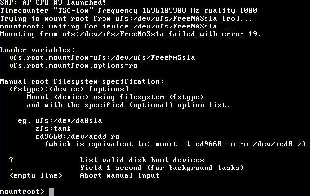

My Inaugural Boot got this far.
I have a Supermicro X10 motherboard, but has a serial number indicating it is fresh, like made in the last month, so I expect it has the newer PCH. The symptom of "can't remount the USB" sounds like what I'm seeing, and was reported as a problem with early Intel chips on USB3.

I moved the USB stick to a USB2 port, and it booted.
Then, the web page locked up (though ping and console menu still worked), and I rebooted. It gave the same error again. I power-cycled instead of just "restart"ing, and it worked again.
I tentatively think that the xHCI issue is still present even though I have a new board. The newer thread I read indicated that it was a problem with the PCH chip and boards made after a certain date would have the newer, corrected, one.

I don't think so. The Intel bug is about USB 3.0 devices not being recognized after the system wakes from S3 sleep. There is no S3 sleep during FreeNAS boot sequence. This is more about the FreeBSD 9.1 xHCI driver being still a bit buggy / incompatible with the chipset. Disable xHCI and your experience should be much better.
