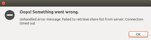

im having some trouble with SAMBA Shares in FreeNAS i have had this for awhile now and cant seem to sort the problem out. SAMBA works in Windows XP, 7 and 10 perfectly fine and on my Phone and My laptop that is running Ubuntu 18.04 same as my workstation but with Ubuntu 16.04 on my other laptop its a different story happens on Lubuntu 16.04 i keep having a message saying, Unhandled error message: Failed to retrieve share list from Server: Connection timed out i have this problem on anything that is running 16.04 version of linux i have also tried Ubuntu 14.04 but still the same problem yet it works on everything else that is not 16.04 based.

Update,
I have solved the problem by forcing Ubuntu to use SMB3. by default it uses SMB1.
