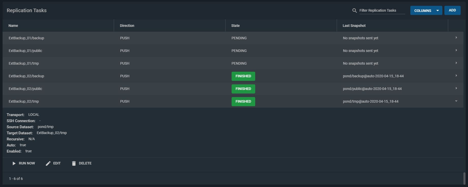

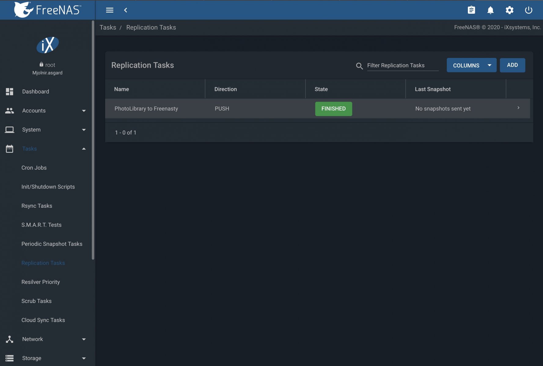

Is there a way to validate the snapshots are actually replicating to the backup location? I am worried it is still not working, as when i look at the Replication task, under the Last Snapshot tab, it says No snapshots sent yet.
I'm also replicating between local pools. My replication tasks are showing Finished with the last snapshot name. You can look under the Storage>Snapshots page and look for the snapshots on the destination pool.
Jerami1981
Jan 4, 2018
32

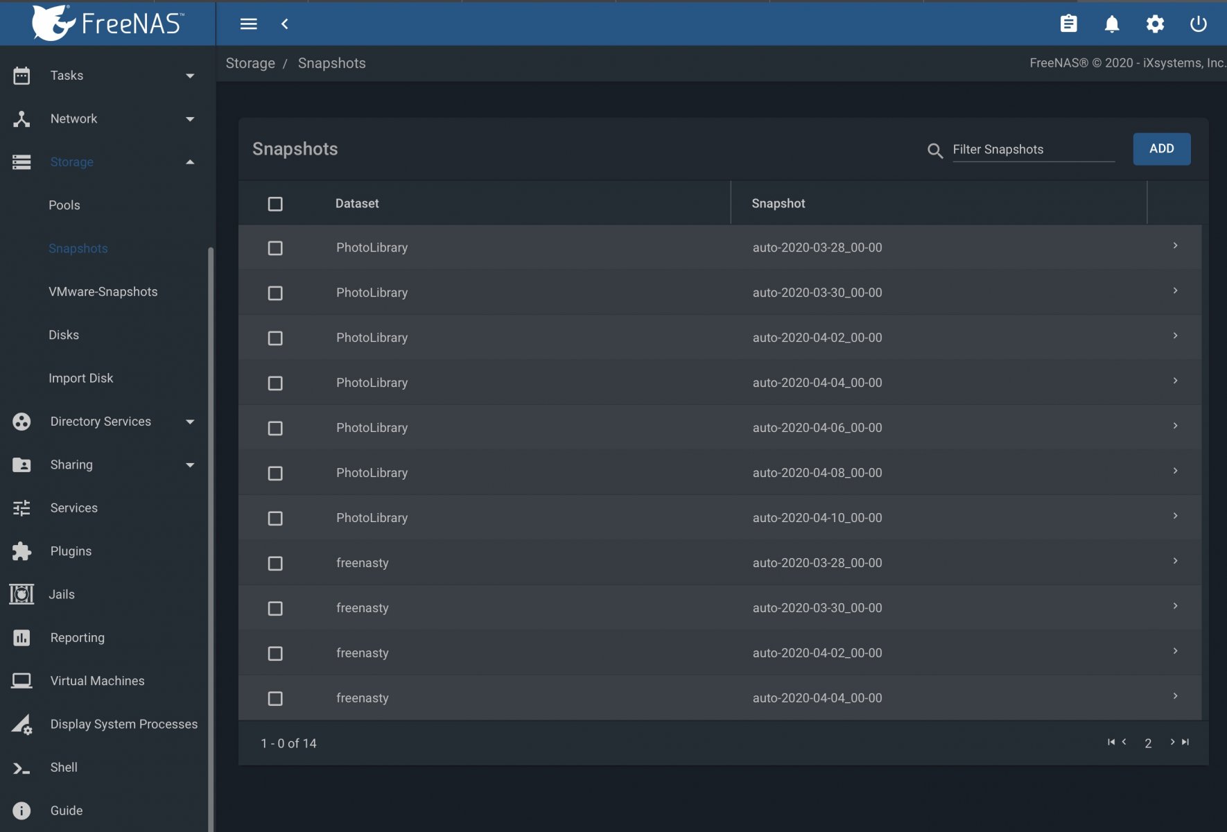

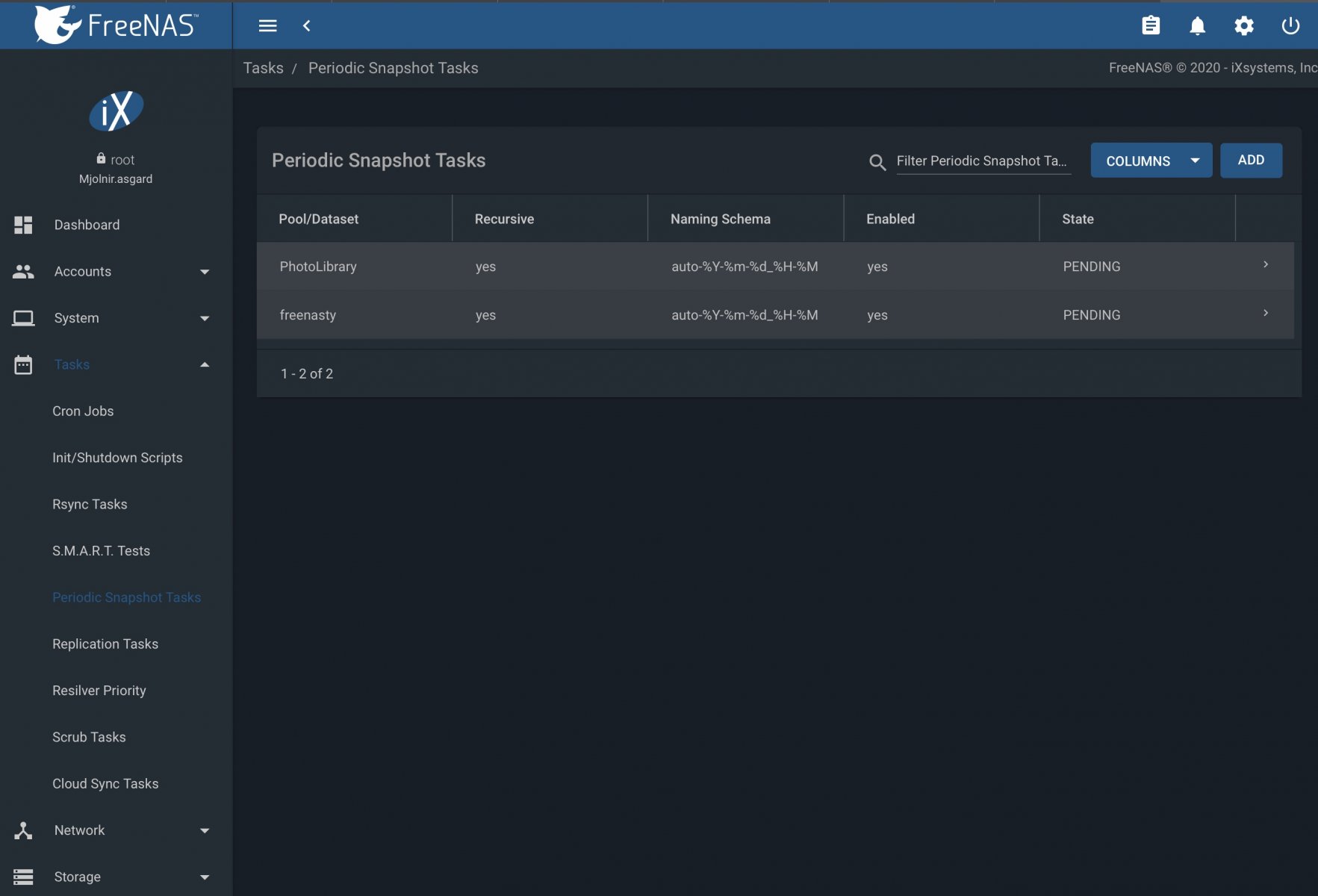

attached are what I see on my replication task, periodic snapshot task, and then my storage/snapshots list. So snapshots are definitely being created, but nothing is being moved/replicated, and there are no errors. It’s probably something simple, but at this point I am at a loss for what it is.

In your replication task page the "Last Snapshot" column should have the name of the last snapshot replicated. It doesn't' look like they are replicating. You can also turn on "Debug" logging in the replication task then run it manually to see if there any clues there.
Also, is the data in the "freenasty" pool only a backup the "PhotoLibrary"pool? If so, I would get rid of the periodic snapshot task for "freenasty".

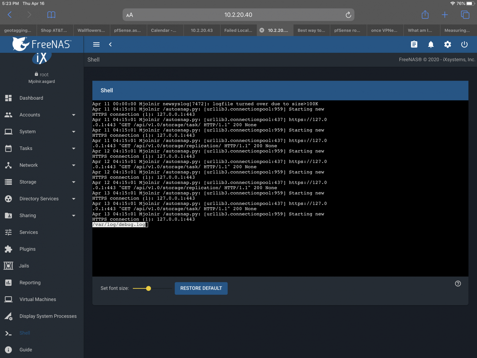

I will turn on debugging and see what comes from that. **Edit** it appears I still had debugging on from when I started troubleshooting this. However, these logs mean about as much as the original errors meant.

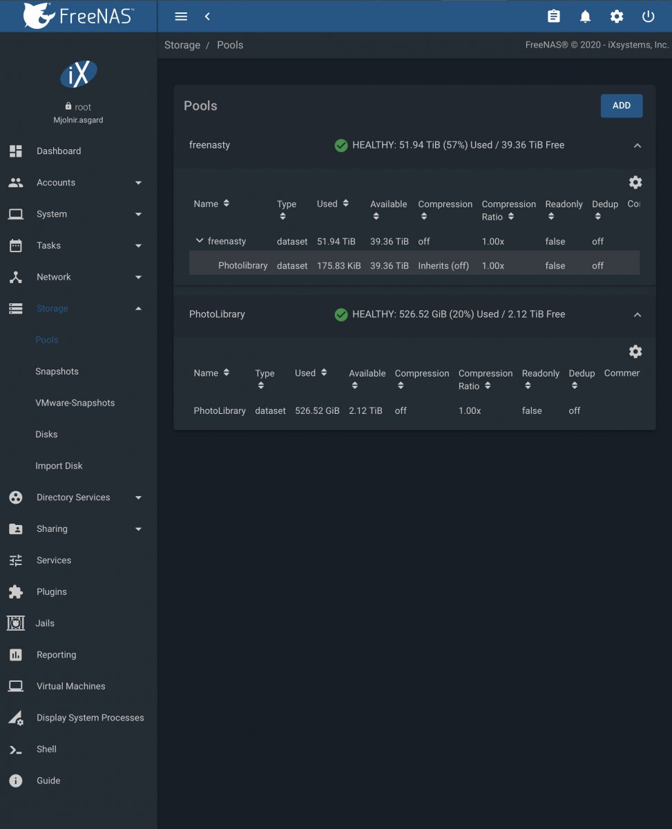

Freenasty is my primary storage pool for everything. In the same chassis, I have a small pool of ssds that i work off of for photography, that i would like to replicate to the freenasty pool on the same device, which then rsyncs a full backup to another server.

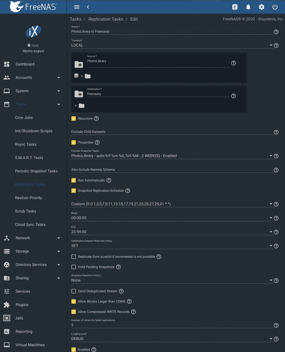

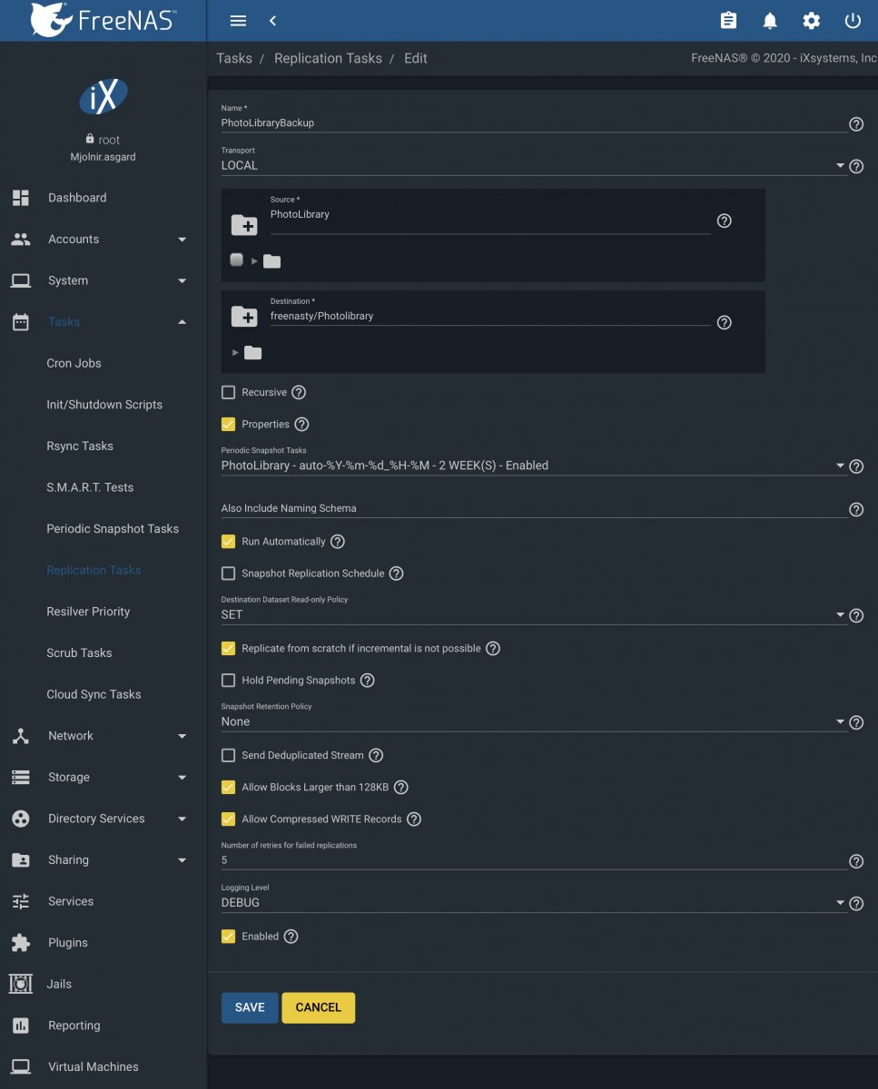

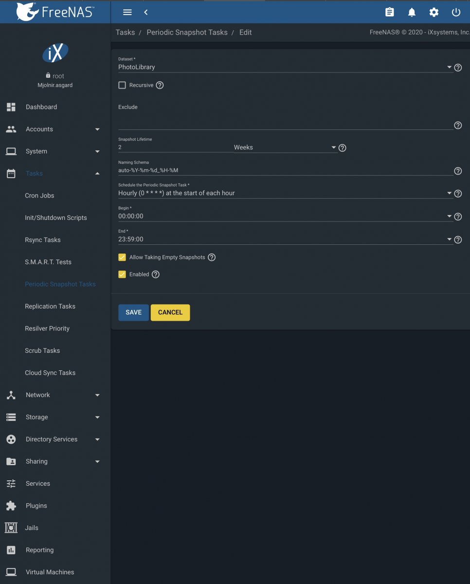

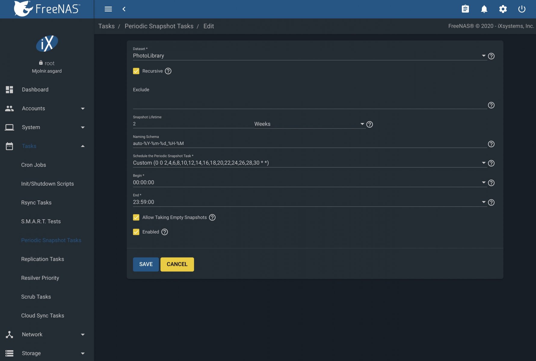

Here are my configs for my replication, and snapshots. I have both snapshots take place one day, and the replication on the next. That seemed to get rid of the error I had originally. Maybe something in here isn’t set right?

I would try manually creating a dataset under freenasty (ex. freenasty/photolibrary), and set that as your replication destination.

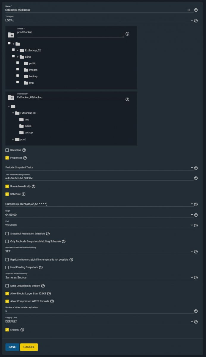

I'm out of ideas. I had lots of trouble moving from the old SSH replication method to the LOCAL method.
If its any help this is how mine is set up. I use non-recursive snapshots and replications. Due to the way I layer my snapshot lifetimes I found it easier to use a set replication schedule vs. tying it to the snapshot task directly.

So i have noticed it appears you have two datasets at the root of your storage. Where as, i have one main pool/dataset, and am trying to replicate to a sub, empty dataset. I wonder if that is why it will not work. I tried setting up a new rep task from scratch and matched yours, other than the dataset being its own pool, and it failed due to the dataset not being empty again.

Pool B (Freenasty) cannot have any recursive snapshot tasks of the pool if it is to receive snapshot from replication.

I have removed all snapshots, and removed the recursive setting from the snapshot tasks. I have now pointed the replication task back to the Freenasty pool, and will update when things have run their course over the next couple of days. Thanks for the info!

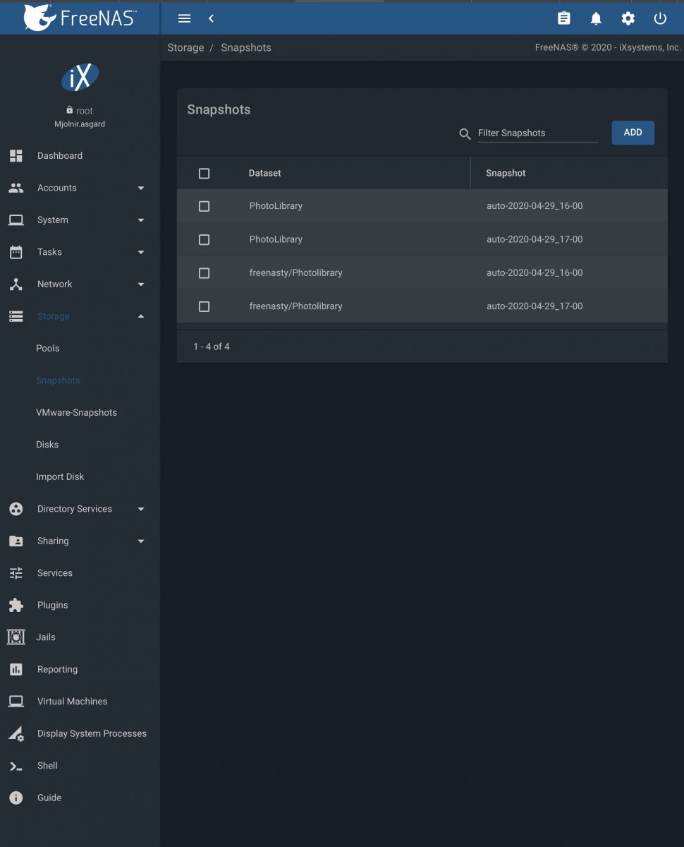

Ok, so I removed all snapshots again. This time I only configured the for the photo library to start out with, and everything seems to be working. Posting my relevant config pages in case that helps anyone else out down the road.
A big thanks to everyone who contributed and gave me some different things to try out
