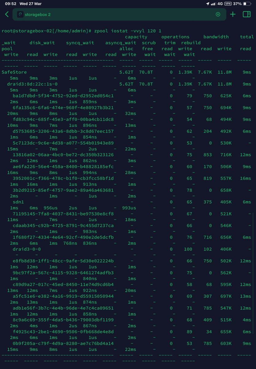

Here’s the results, not sure if they’re good or bad tbh.

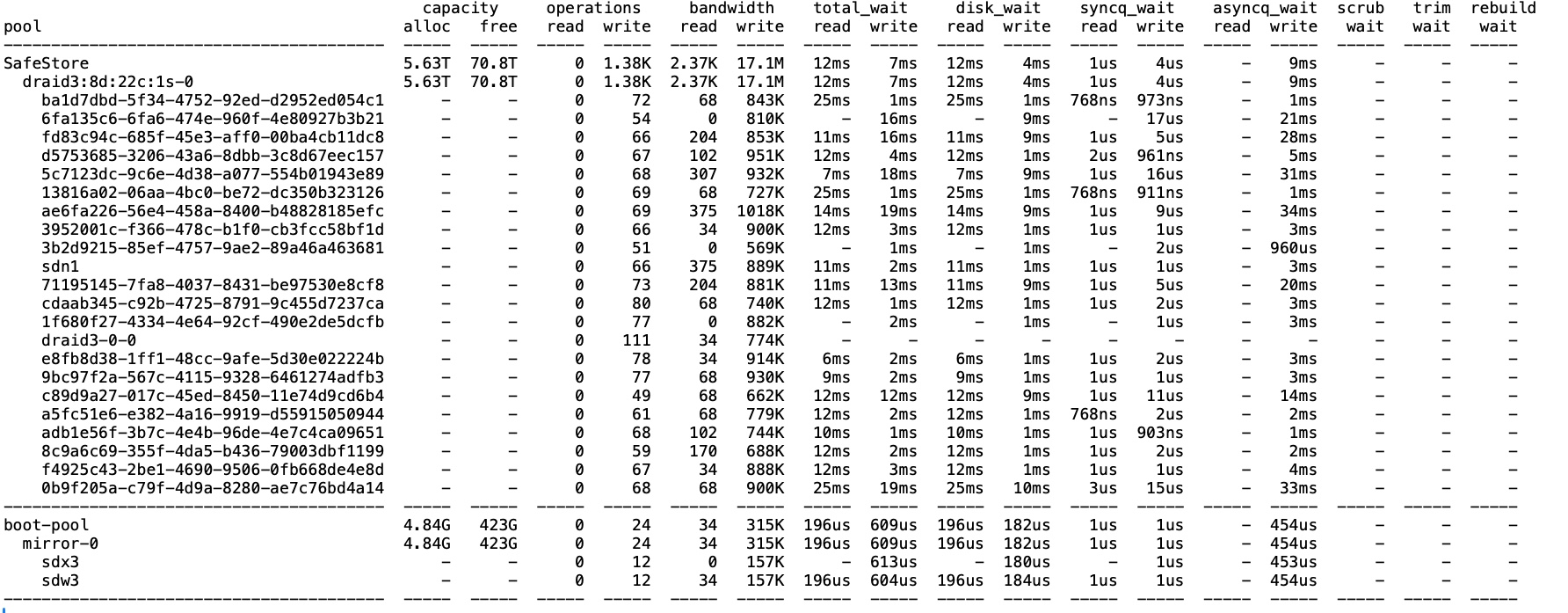

CelticWebs
Dec 4, 2023
18
I’ll do it from an actual computer shortly so that the screen is better laid out to read.

@CelticWebs you have disk latency averaging about 12ms. What this effectively means is that the bottleneck you are trying to illustrate is probably not there. I think your testing methodology is just poorly illustrative of the workload.

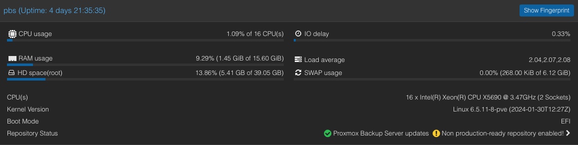

Thanks Nick, I did some tests on my Synology system and figures wise, everything performed better on the Truenas Scale system, whcih you'd expect wit hath spec difference. So I'm at a total loss why It operates so slowly when doing backups and Garbage collection in Proxmox Backup Server.
It's been running for a day on a garbage collection and as you can see, it hasn't got to 2% yet and the system it's self is under no load at all!
I'm wondering if it's the way the VM is setup somehow.
