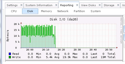

Attached are pics showing the slog's utilization during a write test, like above but with a 5.3TB file. And a shot of the graph showing the CPU side by side over time, raid0/strip on the left, raidZ2 on the write, both writes (read-activity in the middle)
is DD single threaded and i'm core-bound so not able to show the limits of the raidZ2 vs. stripe with 25/24 disks? Why is raidZ2 so close (not really complaining, just surprised to be honest).
