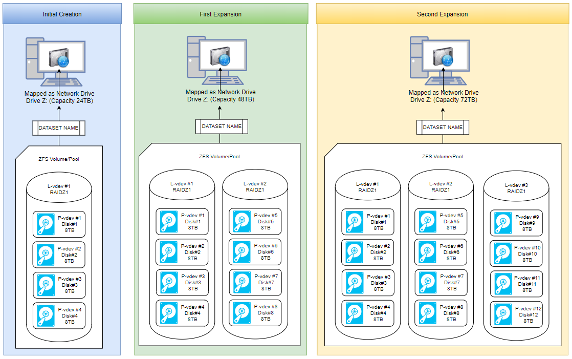

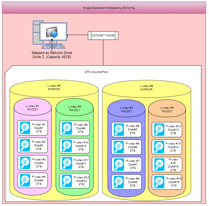

@we7313, not to hijack your thread, but I've got very similar question. However, I really need to start with the basics as I'm still trying to figure out how FreeNAS and ZFS work to begin with. I'm also more visual, so please pardon the graphics I'm including which I created to try and understand things.
From what I understand:
  1. Each physical drive is considered a vdev (let's call it P-vdev).
  2. We then can take a few P-vdevs and place them in a logical vdev (L-vdev) for mirror/stripe/RAID functionality (disk layout).
  3. A Volume (or zpool) can then be made in various configurations of one or more L-vdevs (or even a single P-vdev, skipping the L-vdev level).
So far so good..?
Here is where I start getting fuzzy: On top/bottom of the Volume we create Datasets.
  1. I say top, because that is what gets exposed to external systems. Since there can be multiple Datasets on a Volume, I see them as the upper-part of the hourglass...
  2. It looks bottom simply because the hierarchy tree is nesting below. (I guess if you just flip the hourglass over things would be correct either way).
Someone please tell me which is the correct term so that I don't go bumbling around...
So, I would like to start my build with 4 x 8TB drives in a RAIDZ1, exposing it as a single 24TB 'Drive' for my network (see Initial Creation). Not using RAIDZ2 as the truly important files are already on a 2TB RAID0 with two cloud backup services monitoring them. This would be used for a media collection; data gets completely fried, oh well. But I'm still using some level of safety because its just prudent.
One cannot perform a Windows span-like function for one Dataset across multiple Volumes. Not the best practice, even in Windows, IMHO.
However, adding a second L-vdev to the Volume (original question) is possible, and best to have it as similar to the existing L-vdev in drive speed, size and layout.
Questions:
  • Does the existing data in the pool get redistributed to the new L-vdev? If yes, is the Volume in a degraded state until its done? If not, how is the new data distributed?
  • Based on my image below, the First- and Second- Expansions are what the OP was wanting to do. .?
  • How about after doing a First Expansion and then wanting a mirror for speed/redundancy? Would I create a mirror of each L-vdev and have a Volume with two mirrors?

Actually not much of that is correct, you need to read up on the resources in this forum. @Chris Moore has some awesome links in his signature.
Also, you shouldn’t hijack unrelated threads. This should have been its own.

  • Each physical drive is considered a vdev (let's call it P-vdev).
  • We then can take a few P-vdevs and place them in a logical vdev (L-vdev) for mirror/stripe/RAID functionality (disk layout).
  • A Volume (or zpool) can then be made in various configurations of one or more L-vdevs (or even a single P-vdev, skipping the L-vdev level).
1. No, a drive is a drive, a vdev is a vdev.
2. No, you take drives you put in vdevs and you take vdev you put in pools.
3. Yes, but again there's only vdevs (no P or L vdevs) so only one level.
1. No but new written data will. The more a vdev is empty the more data will be written to it. For example if you have a a vdev with 20 % space left and another with 90 % then you'll have far more data written to the second vdev until everything is more or less balanced.
2. Yes.
3. No. You can't change vdev layout (not for now at least). No, you can't mirror vdevs.
As others already posted please read the links from the signatures (especially https://forums.freenas.org/index.php?threads/comprehensive-diagram-of-the-zfs-structure.38865/ and "Terminology and Abbreviations Primer" and "Slideshow explaining VDev, zpool, ZIL and L2ARC"), it'll make things far more clear.
