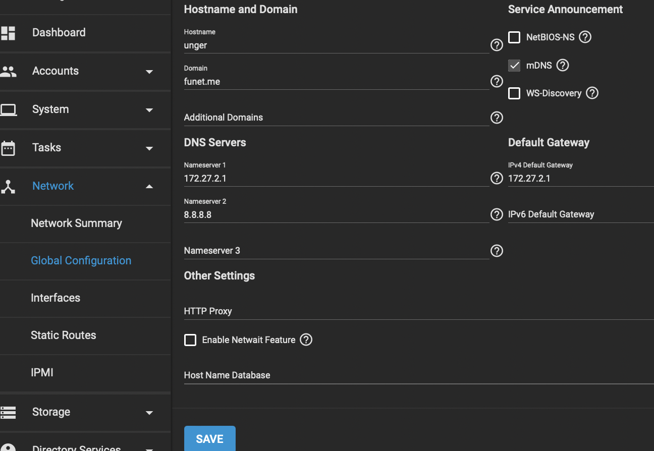

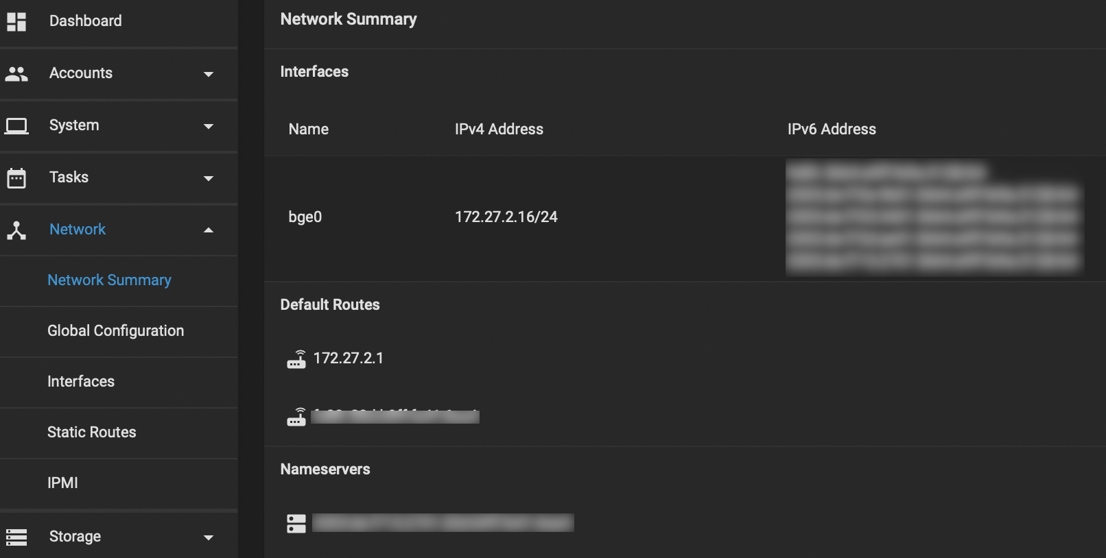

Same here.
Configuration, IPv4 nameservers are there just fine:
Result, no IPv4 nameservers shown:
I guess this is the reason for the broken resolv.conf. IPv4 nameservers are missing from that as well ...
