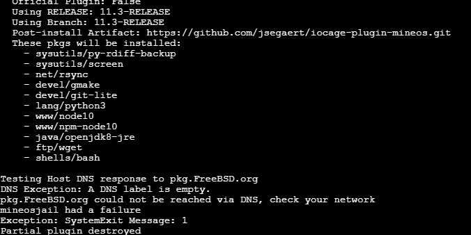

I've been trying to install my first set of plugins with FreeNAS 11.3, and I keep running into one of two errors:

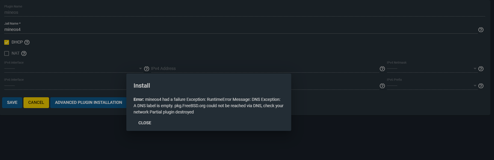

When I try using NAT or DHCP, i get the following error:
This error occurs with a whole host of plugins (my goal is to get mineOS and plex up and running, but I tried a couple and got the same results.)

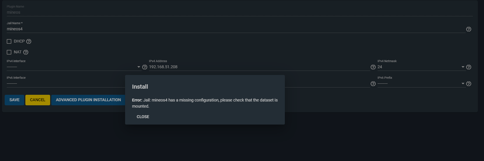

When I specify a static IP, I get a little further, I think, and see the following:
Trying to do it on the command line, I haven't been able to get past the DNS error. And I've tried a lot of different combinations.
iocage fetch -P mineos -n mineosjail
iocage fetch -P mineos -n mineosjail vnet=off allow_raw_sockets=1 bpf=off dhcp=off ip4_addr="re0|192.168.51.208" resolver="192.168.51.1"
iocage fetch -P mineos -n mineosjail vnet=on nat=on
iocage fetch -P mineos -n mineosjail vnet=off dhcp=on
etc...
They all lead to the same result:
I've done a bunch of searching around for answers, but haven't found any solutions, though plenty of similar problems. Anyone have any ideas? This is happening for MineOS, plex, and jenkins.

Do you have a default gateway specified? Check this in the FreeNAS Web UI, menu Network>Global Configuration. This should be populated with the IP address of your router.
Also, from the screenshots it seems you have a Realtek NIC. These are not as well supported as Intel NICs.
