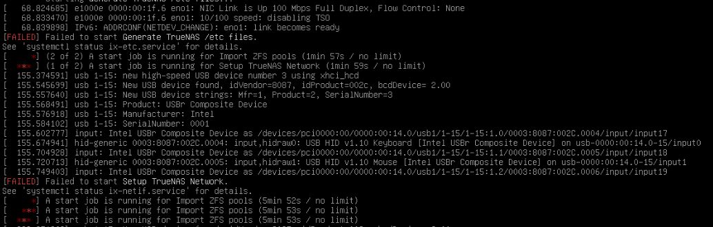

I'm attempting a fresh installation of TrueNAS Scale using the latest ISO (22.02-Rc.1-1), and am running into some problems on first boot. I was able to install Core fine on this hardware (described below), but chose to wipe that installation and start over with Scale. Upon first boot after the installation completed, I got a series of warnings, and eventually the system got stuck at `A start job is running for Import ZFS pools (15min 21s / no limit)`, where it sits counting up forever. However, before that, it appears that another job (`Failed to start Generate TrueNAS /etc files`) also failed, which could be the cause of subsequent issues if config files in the /etc directory weren't generated. This happens every time the system attempts to boot. Below is an excerpt of the boot process.
