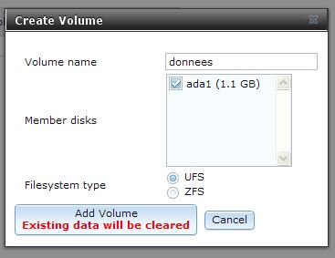

Hello,
Thanks for your reply, I tested the version "beta 3" but the problem is always present, the error message is different (see the attachements) freenas - FreeNAS-8.0-n1.jpg freenas - FreeNAS-8.0.jpg .
You see the configuration about the disk "ada1" and the reply.
I do this test with virtualbox (last version); when I try virtualbox with "FreeNAS-8.0-RELEASE-i386.iso" I have the same error as indicated yesterday "donnees /mnt/donnees Error getting used space (Error) Error getting available space Error getting total space ONLINE".
I conclude that "virtualbox" work correctly.
Regards.

You need disks of minimum 3GB, as FreeNAS creates a swap partition of 2GB on each disk. That is why you get the failed partitioning. Prior to beta3 it also failed, but without giving an error. That's why you get the 'Error get space' messages using the 'RELEASE' version.
I encountered the same problem when testing under Virtualbox, increasing my disks to 3 or 4GB solved the issue.

Hello,
At sjieke : thanks for your information, it corrected my problem.
Exactly for the "beta 3", the error "Error getting used space" is always present.
