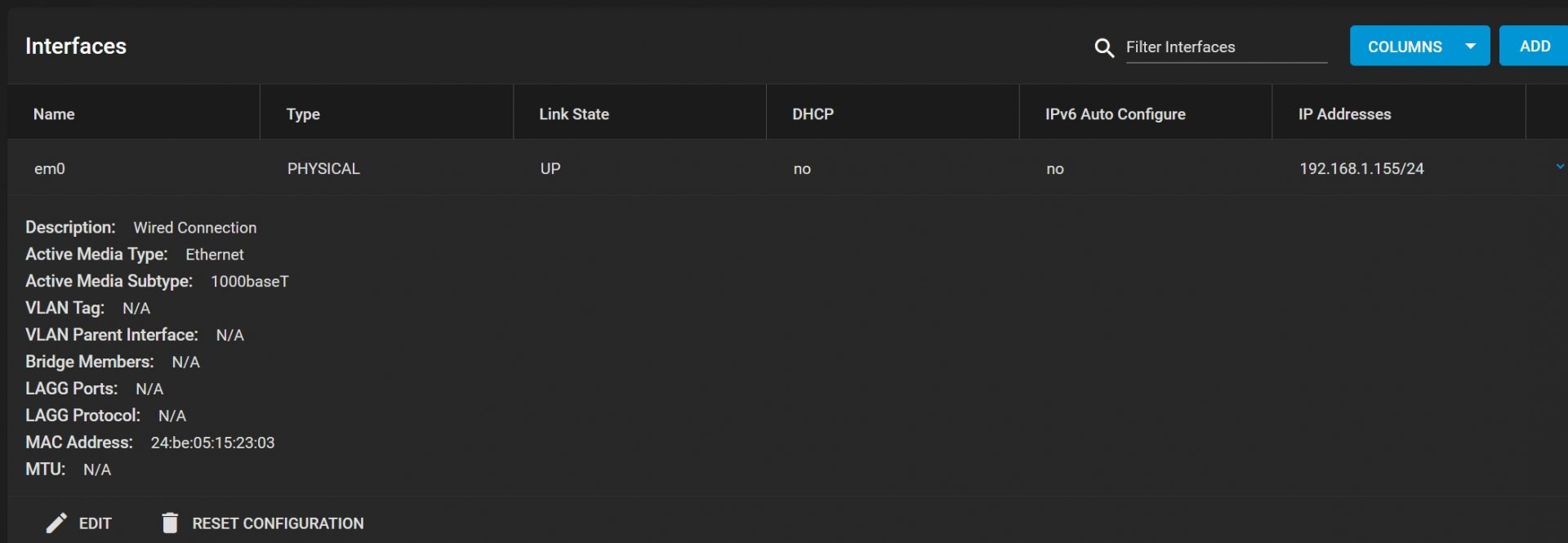

Have you looked at the Network Interfaces Screen, expanding it as necessary?
Please post a screenshot of it.

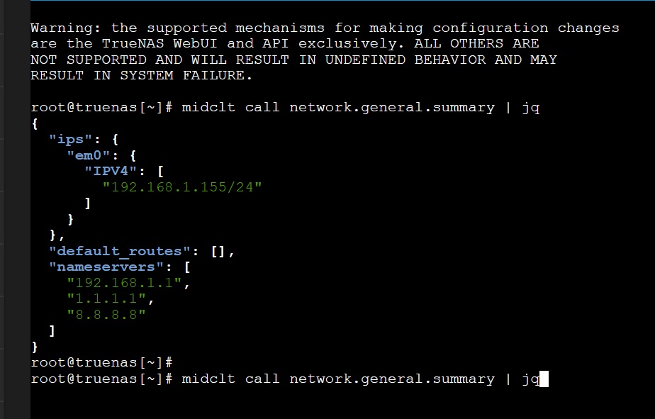

What's the output of midclt call network.general.summary | jq? From your description, you're probably missing a default gateway, or typo'ed it in some way.

here's the output of midclt call network.general.summary | jq

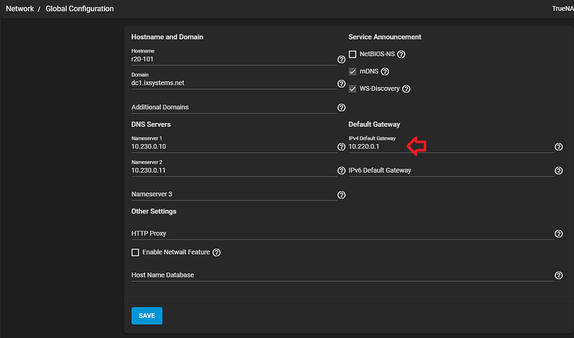

As I suspected, you don't have any default gateway set up. The network summary output confirms it. You set it in the Network->Global Configuration screen where you set up the DNS servers.
