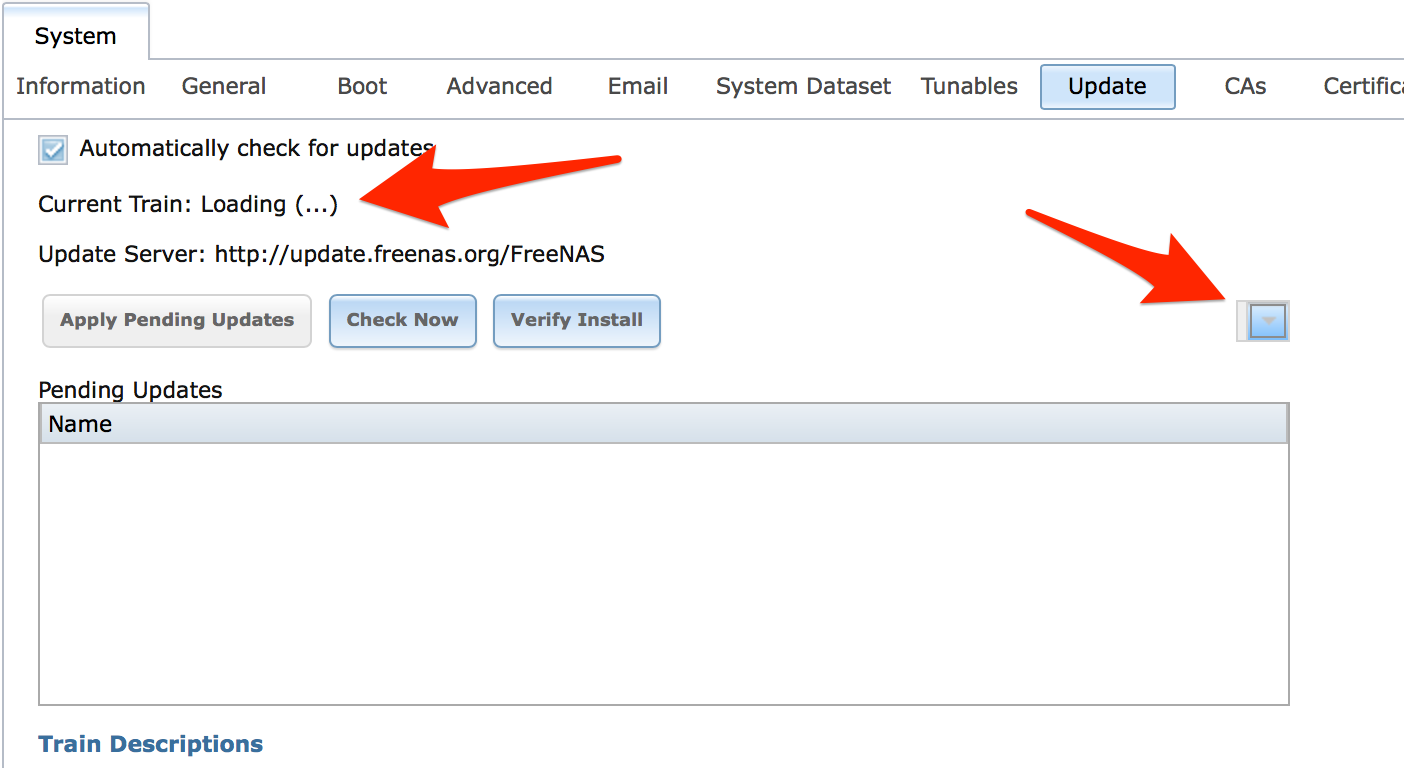

Under Update I see the following:
index.php
Current Train remains at Loading (...) and the dropdown it empty.

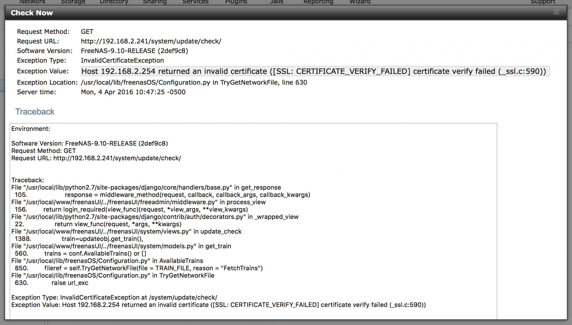

More concerning is the error thrown when I click Check Now.
index.php
The host in the Exception Value is the IP to my router. This error occurs whether I have my CA imported or not.

I have now tried FreeNAS-9.10-STABLE-201603252134 with the same results. I have also run update-freenas from the shell with these results. it's a little cleaner than the images so posting here.
[root@freenas ~]# freenas-update update
Unable to load http://update-master.freenas.org/FreeNAS/FreeNAS-9.10-STABLE/LATEST: Host 192.168.2.254 returned an invalid certificate ([SSL:CERTIFICATE_VERIFY_FAILED] certificate verify failed (_ssl.c:590))
Unable to load [u'http://update-master.freenas.org/FreeNAS/FreeNAS-9.10-STABLE/LATEST']: Host 192.168.2.254 returned an invalid certificate ([SSL: CERTIFICATE_VERIFY_FAILED] certificate verify failed (_ssl.c:590))
Received exception during download phase, cannot update

## Sorry, I don't see where to mark this problem resolved ##
Doh! Now I feel like a dope!
My squid (and/or squidGuard proxy filter) was causing this problem. I'll have to spend some time to figure to exactly what part of it was causing the problem. But, for now I set squid so that my FreeNAS server bypasses the proxy server.
Something changed in a previous version. I never had to bypass the proxy for my FreeNAS server in the past.
Thanks anyway. Crawling back under my rock.
BrianRW
Apr 4, 2016
6
I know that the problem has since been fixed in 9.10. I can set System>General>Protocol to HTTPS and the issues no longer occurs.
