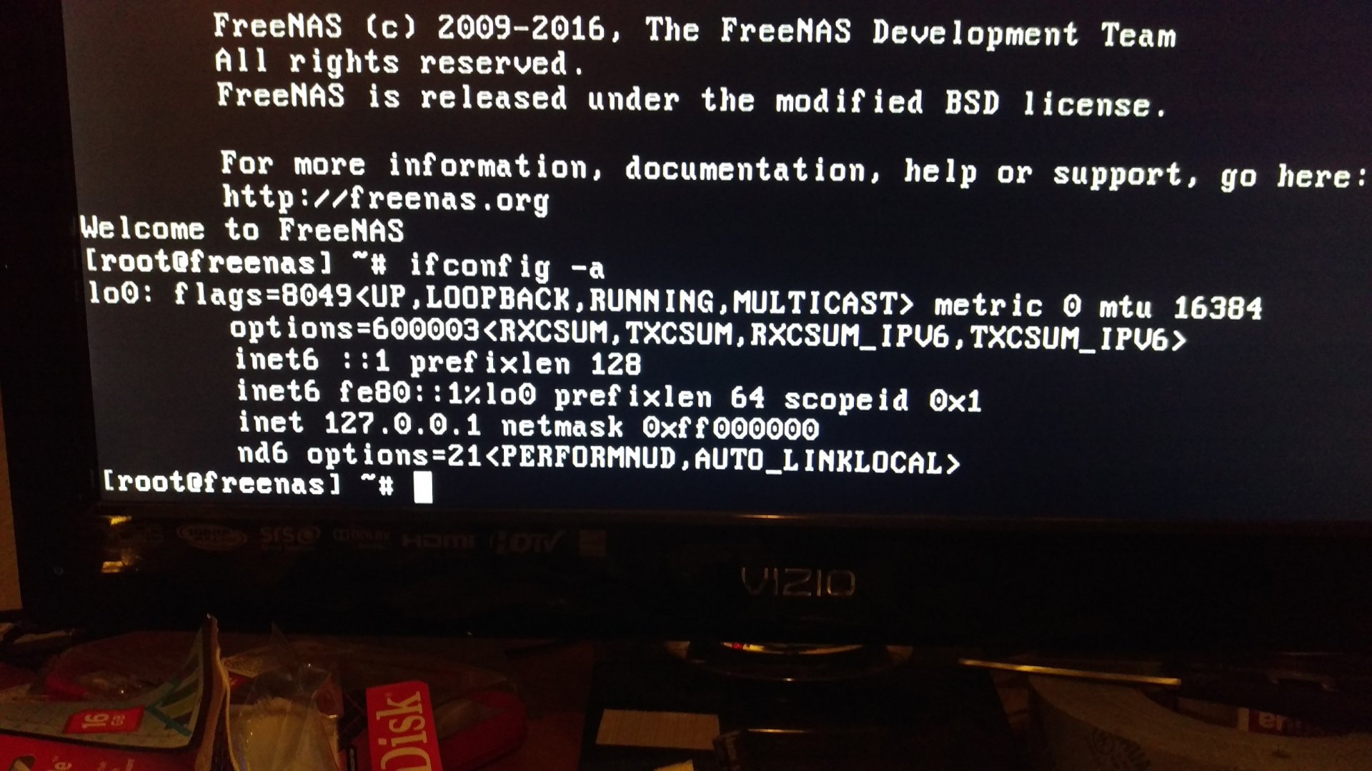

Thank you, I forgot about the other terminal windows (F1-F7.) Running the command "ifconfig -a" shows only one adapter, and it is not 'eth0' like I am used to. Is it possible the OS cannot find my network ports? I have attached a picture of what is displayed on the terminal.

That's the loopback device. So for whatever reason, none of your ethernet devices are recognized by the OS, and that's what caused the problem. Obviously it shouldn't do the crash, but I think that means you've got another bigger problem.
