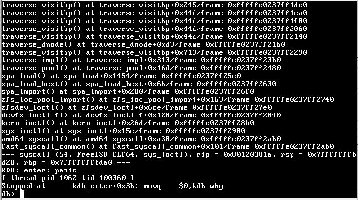

I found a couple of threads about users experiencing the Error "kdb_enter +0x3b: movq" during install, but I am getting this error while FreeNAS is booting and trying to import the POOL.
How did I get there? I wanted to access (READ) some data on my FreeNAS and while browsing, it became inaccessible. It has rebooted and when I connected a screen, I saw this error.

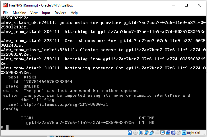

I tried the single user mode and zpool import command and it reports ONLINE.

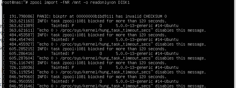

I have done an clean install of FreeNAS and then tried to import the pool and it became inaccessible again.

The error I am getting when booting normally:
Then booted single user mode and tried:
set vfs.zfs.recover=1
set vfs.zfs.debug=1
boot -s
zpool import -nF

The result is identical with the first screenshot. I get the kdb_enter +0x3b: movq error and end up in some sort of db> console.
I get the same result whether I attach the HDD and I try to import the pool on the actual PC or to a virtual machine on another PC with 8GB ram.
You might need to try a different OS entirely (with ZFS support of course) since it looks like it's panicking on import.
