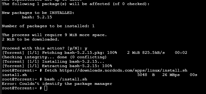

You could do
pkg install bash
fetch https://downloads.nordcdn.com/apps/linux/install.sh
bash ./install.sh
But it probably still won't work because TrueNAS CORE is not Linux and VPN needs specific kernel interfaces and support.
You could try to use the OpenVPN client available in the UI.

TrueNAS CORE is not Linux as I wrote. Please do not post screenshots for command output but copy and paste text
in code tags like this
instead.
Thanks.

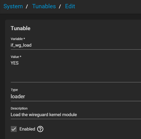

Why not just install wireguard in the jail? It's supported by NordVPN, is simple to install and set up and only requires a configuration file for connection.
Oct 22, 2019
3,641
Does NordVPN offer on its website/dashboard a place to "generate config files"?
If so, you can generate WireGuard config files, which will work with the standard wireguard-tools and wireguard service in FreeBSD. The relevant package needed in the jail is wireguard-tools
This is what I do in my qBittorrent jail. (I am not familiar with NordVPN, however.)
Make sure you have the host, TrueNAS Core itself, load the kernel module, so that it is available to the jail.
