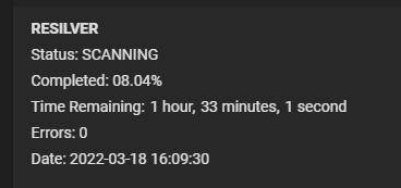

edit: i think it might be because autoreplace is set to enabled, so my guess is that upon inserting the drive, it automatically started replacing, and when I tried to do it through the UI it timed out or something because it had already restarted
edit 2: nope its definitely some sort of bug. I swapped a second drive (different vdev, one disk), and let it sit for 10 minutes.. No automatic resilver until i started in the UI. Once started in the UI, same error.

So first disk finished replacing, second is close to being done, but one thing I've noticed now is that (again, via the UI), the new disk does not have a GPTID/1233abcd id, it has da0p2:
