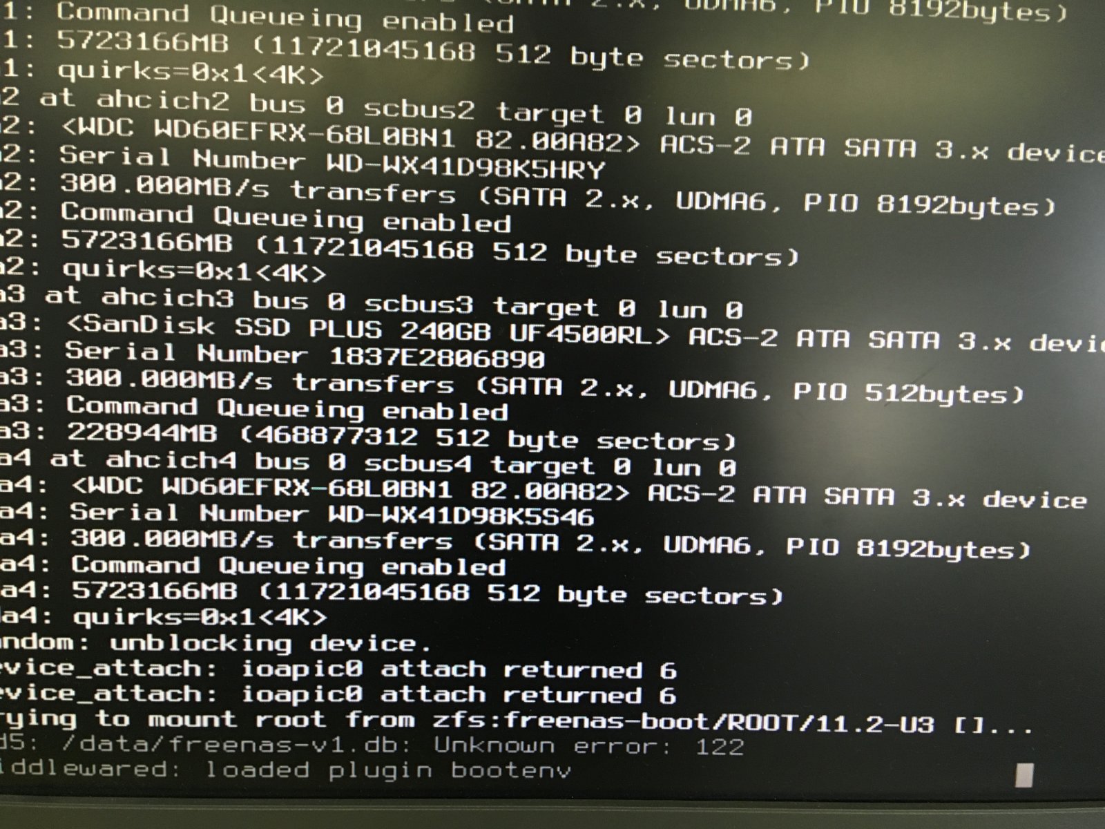

error booting nas /data/freenas-v1.db error 122
ciccio
Jan 15, 2019
27
Hi I restarted the freenas (v.11.2-u3) and hangs on the line you see in the picture.
What is the problem and above all HOW TO SOLVE IT?
I have TB of data in it....
Chris Moore
May 2, 2015
10,079
This looks to be a boot media failure.
The data is in a separate storage pool, so it's actually not affected by this.
ciccio
Jan 15, 2019
27
thank you. to restore you say that I just need to reinstall freenas and import the disks? and the various configurations?
Chris Moore
May 2, 2015
10,079
Chris Moore
May 2, 2015
10,079
All configuration is in the configuration database. If you have a backup, you can quickly restore it after the reinstall.
