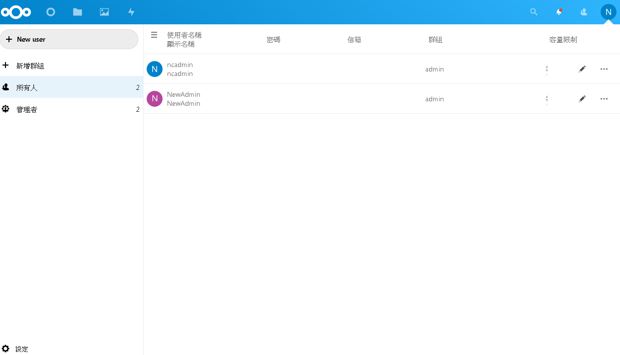

Thanks!!! It worked for me! Even when i submitted the new Usernames and passwords when entering the base URL, the Server loaded and recieved a time out, but after reloading i finally logged in my account and it worked!!!I seem to have fixed my fresh NextCloud plugin installation. Here's what I observed and fixed along the way.

to get back into that type of workflow.Would you please give help to double check if my below steps were something wrong/missing? Hope below steps would help everyone here, thanks again:
Step1. Click Jails-->select nextcloud-->shell
Step2. input: cd /usr/local/www/nextcloud && mv apps apps-old && mv apps-pkg apps
Step3. input: edit /usr/local/www/nextcloud/config/config.php
Step4. add 1 new line into bottom of the config.php file with: 'logfile' => '/var/log/nextcloud/nextcloud.log', than save changes
Step5. input: service php-frm restart
Step6. input: edit /usr/local/www/nextcloud/config/config.php
Step7. find the line 'installed' => true and change into 'installed' => false
Step8. open a new page in Chrome/FireFox and key the nextcloud's URL(for me is 192.168.1.101)
Step9. log-in/key-in/create with NEW account(not ncadmin), the DB connection key with the pos-install details
