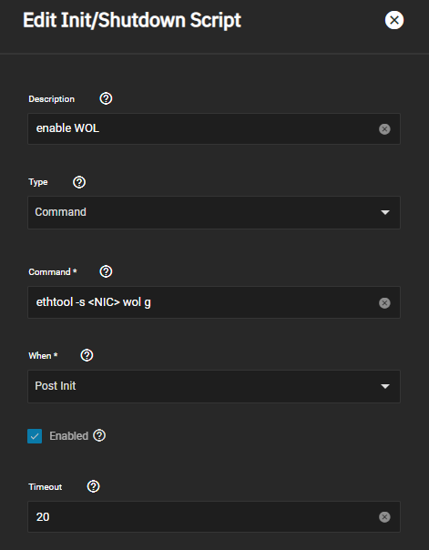

Aug 4, 2022
Hey everyone,
Normally eththool should be installed by default in SCALE.
I used the solution of darkyere, but instead of creating a system service, I added an Init/Shutdown Scripts (System Settings > Advanced).
Hope it will survive next update, but since it's done in the GUI, I have good hopes.
Here is a screen capture of the script I use, and it works well : don't forget to replace the <NIC> with the right interface.

I've found this thread because I had WoL enabled in BIOS/UEFI, but it didn't work. Enabling WoL inside of TrueNAS using ethtool like this did work:
ethtool -s enp4s0 wol g
...so I've followed #14 because I'm not sure if manually created/changed files would survive the TrueNAS update.
@papaours Thanks for the idea!
