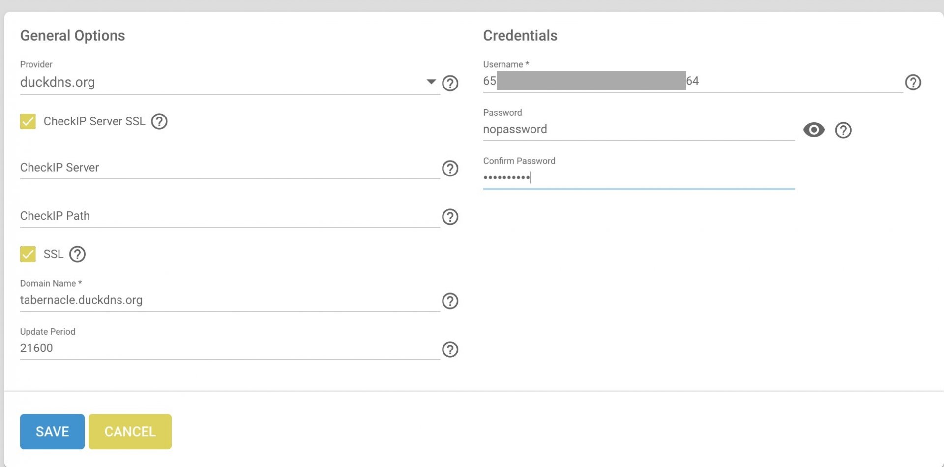

Here's what I have:

I worked it out for my TrueNAS Scale deployment through the UI.
As @Glorious1 said, you go to Services -> Dynamic DNS, select duckdns.org as the provider. You can check both the `CheckIP Server SSL` and `SSL` boxes. Then for the `Username` field, enter the token you got from DuckDNS and for password you can enter anything (it doesn't matter) so put `changeme` or `nopassword` or something
Once you hit `Save` you should be able to activate the service and select the `Start Automatically` box. If you have any further issues, you can look at the logs by SSHing into the server and looking at `/var/log/user.log` as you activate the service. Also, it looks like that page is just a wrapper around this configuration file (https://github.com/troglobit/inadyn/blob/master/examples/duckdns.conf) which will be on your system under `/etc/inadyn.conf` so you can play around with that too until it works

Thank you @pverona! For some reason I was trying this again today and bumped into this old thread. Your magic permutation worked for me in Core.
Just to be clear if anyone else is trying this, the fields CheckIP Server and CheckIP Path can (should?) be left blank.
By the way, in Core there is no /var/log/user.log, and the conf file is at /usr/local/etc/inadyn.conf
