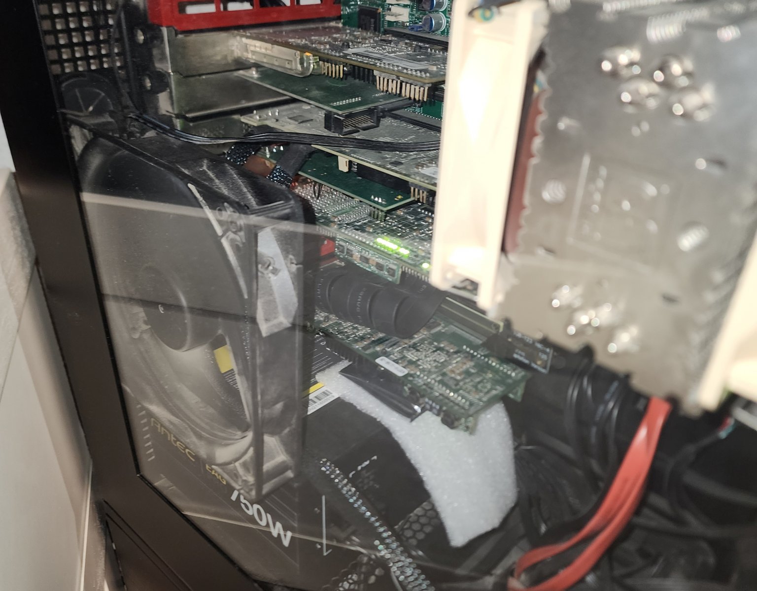

Actually, I had problems with the overheating of my 10gig NIC. According to the sensors package installed on the host OS (Proxmox), I noticed temperatures up to 90C while copying files. Unfortunately, my HBA card doesn't have sensors (or they can't communicate with the software). So to handle this issue I installed a large 200mm fan in front of all my cards (see below the photo)
The temperature immediately dropped to 60-70C max for the 10G fiber NIC. Hopefully, it helped other PCIe cards as well.
