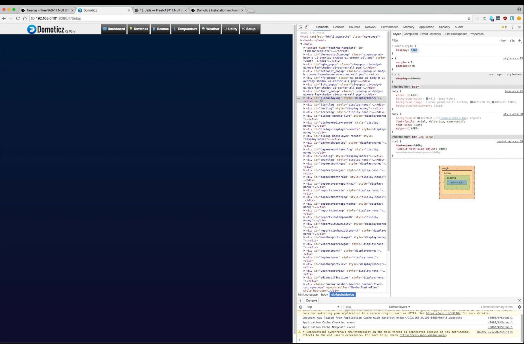

Espejot
Feb 4, 2018
I have FreeNAS-11.1-U1 running and Domoticz in a warden jail. I have also Aeotec Z-Stick Gen5. I did try to instal stick into a iocage jail but symbolic link to the domoticz jail did not work. I do not know much about linux or FreeNas but i have a friend who helped me. But my friend has no knowledge about Domoticz or configuration scripts of the Domoticz. But anyway, he was able to fix some structural errors of the "/usr/local/etc/rc.d/domoticz" file.
Now autostart is working but Domoticz UI is not responding and there is no content at all. Some links, like 'update' and 'security panel' do work but rest of the menus is not working and there is no content. We had no ideas what is wrong but we are guessing that there is something wrong with Domoticz configuration. Sorry for the bad english.
EDIT: Content is there but are hidden with display none css property
EDIT2: Problem solved installing 'openssl' and UI is working.
