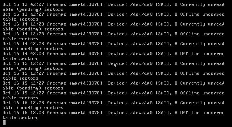

Hi, I recently noticed this error when I plugged a monitor into my FreeNAS box.
Does this mean I need to replace the drive?
Also would this error cause my FreeNAS to grind to an almost complete stop while writing to the drives. It is taking 30+ mins to copy a 400mb file across to my FreeNAS from my Windows 7 PC (CIF Share) and while the copy it taking place my whole PC hangs.

Yep those are smart errors, time to replace the drive. Do you have email notifications setup? FreeNAS would have notified you of the bad drive if you did.

Thanks for reply - Yes I do have email notifications but I'm not and didn't get any mail.
As an aside I went for WD RED drives as I thought they would be good this is the 4th one to go KAPUT inside 12 months.
Would that cause my system to grind to a halt? It is virtually unusable at the moment!!

You should post your smart info for that drive. If you have had several drives fail I suspect something else is wrong with your system.

Rather than starting new threads, please post the results of: smartctl -a /dev/da0 using code tags.
Doing so, will preserve the formatting, making it easier for us to read.

Here's the output from smartctl command you suggested. I realised it's one of my old Seagate drives that is erroring not my WD Reds. Sorry for double post thought it might have been 2 differant problems.

Here's a snippet of the results from your SMART query.
Your hard disk has been powered on for 14526 hours. Lines 197 and 198 should be zero. This is what you are seeing the errors on the screen print you provided.
While you may have email notifications setup, you aren't running SMART tests on a regular basis. The last short test you ran was 10,211 hours ago. Had you been running the short and long (extended) tests, you probably would have been notified of the issue.
Read the section of the manual that describes how to configure S.M.A.R.T. Tests. Here's an example of how cyberjock has configured the tests to run on his server - https://forums.freenas.org/index.php?threads/scrub-and-smart-testing-schedules.20108/
To run the short test on demand: smartctl -t short /dev/adaX Substitute your device for adaX. A short test should only take a couple of minutes. To run a long test substitute that word in the command. It will take several hours to run. You should run these tests on your other drives, to get an idea of their health. How did you know which drives to replace in the past?
Lastly, when posting information like this in the future, please use the code tags. And the beginning of the code, insert (code), at the end use (/code). Replace the parentheses in my example with square brackets "[ ]".

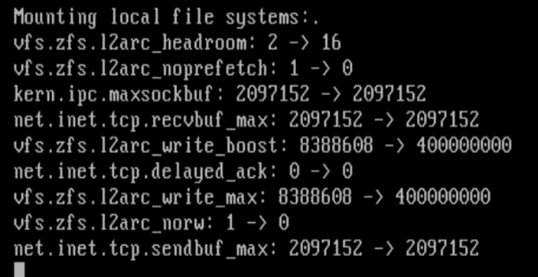

Upon a reboot it mentions l2arc, I've never noticed this before does it always boot up this this. I don't have a l2arc setup.
It's most likely normal but just thought I'd ask.
cyberjock
Inactive Account
Mar 25, 2012
19,525
That's just tunables and is inconsequential to the problem you are having.
You might want to check your new disk and make sure it doesn't have problems. ;)
