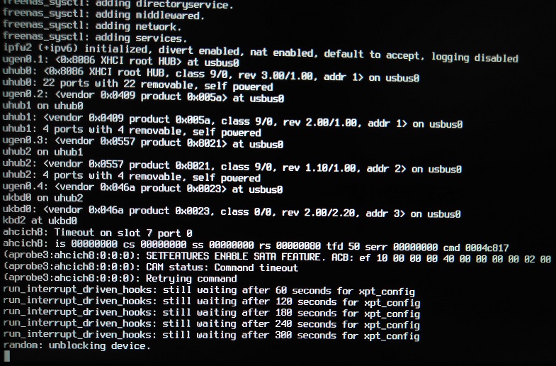

The card identifies as
and FreeBSD chokes when trying to send a CAM command:

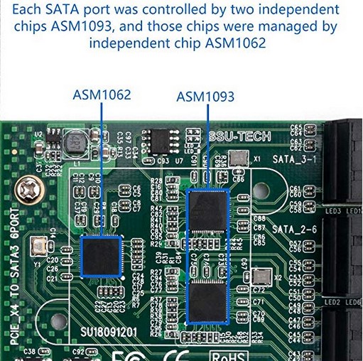

The card seems to have 2 x 6 ports. There is a picture of the hardware layout on amazon:

These controllers with port SATA multipliers are usually very bad news, I see lots of timouts using them on Linux, assume the same would be true for FreeBSD.

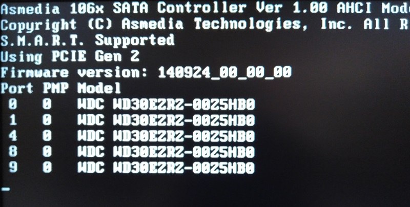

I got three of those budget ASM1061 cards, and they work fine with 5 harddisks. Only disadvantage is the flimsy SATA Port adapters which don't lock the plugs properly.

The 2 port Asmedia controller is very good, I've used several myself with Linux and FreeNAS and they work very well, the problem is when there are port multipliers involved, there's also a 10 port model with port multipliers which is also nothing but trouble, AFAIK Asmedia only makes a 2 port controller for addon cards, so anything Asmedia based with more than 2 ports should be avoided.
