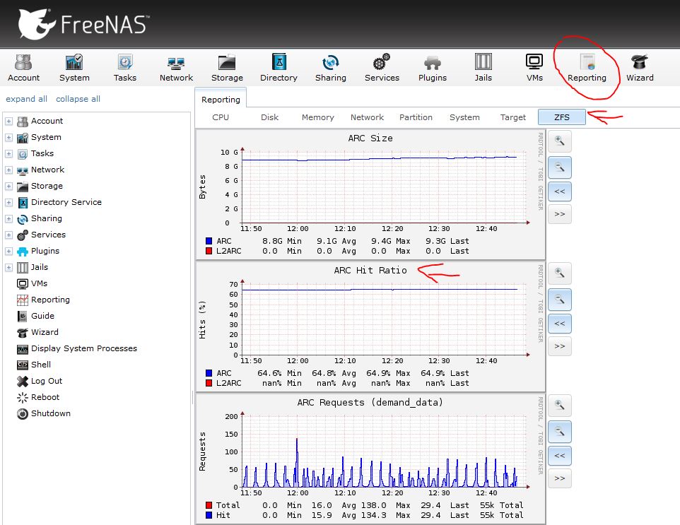

Can you please tell me how to check for ARC Hit Ratio?
Chris Moore
May 2, 2015
10,080
Just click the Reporting button in the top menu, then click the ZFS button in the sub-menu, then look at the charts.
Muku
Dec 19, 2015
26
Look at this. View attachment 21443
Hello @chris, my reporting page looks like this
Can u explain what does the charts say? Does the system actively using only 10 GB of RAM out of 16? And why is my ARC hit ration so high:eek:? I just use my Freenas as a home file server with occasional uses with hardly 1-2 user accessing it simultaneously.
Bidule0hm
Server Electronics Sorcerer
Aug 5, 2013
3,710
Yes, but it's only the ARC, the rest of the system can use the other 5-6 GB.
That's normal. The higher the better. It show you get most of the data from the cache (ARC) and not the pool so it's faster.
