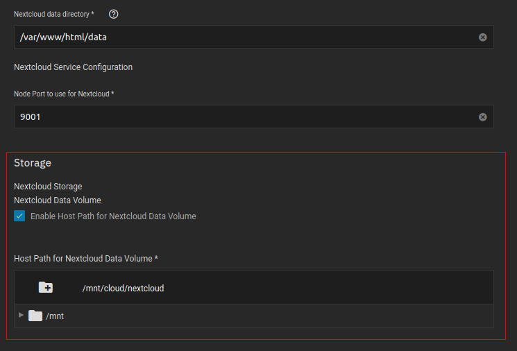

tuuxx
Jan 23, 2020
Hello Marc,
good question! My first thought was, it is the "Nextcloud data directory" in the settings but I never found the path (/var/www/html/data).
My other question is, how has you configured Traefik, the reverse proxy, so that your nextcloud container is using ssl?

tuuxx
Jan 23, 2020
Thank you, for your answers.
You also don't backup a container, you can only backup the storage that is attached to the container, which is stored under the ix-applications dataset on the pool you selected for your Apps to be stored in.
Perfect, that means everything important (data+config+database) is stored in my case under "/mnt/cloud/nextcloud"?!
