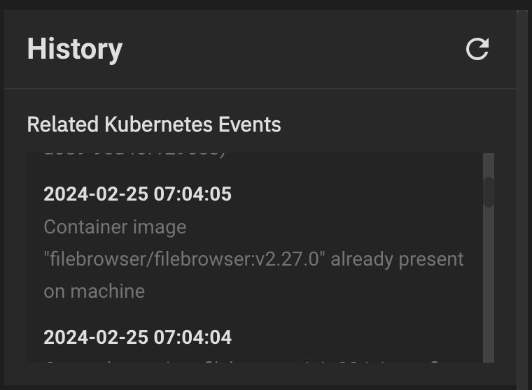

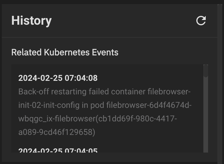

Were you able to fix this? Looking to see if anyone has found solutions to this. I have downloaded filebrowser before, but deleted to reorganize my dataset and getting the same error. I Deleted it multiple times and have deleted/recreated the dataset as well while checking Container Images and saw that it was deleted. I'm curious if one of the solutions above helped as well.
If the only way to make this work is in the shell, please share the specific commands that are needed, thanks!
The Logs aren't showing much as well...

But as sretalla noted above, you need to look at the container logs, not the logs you are showing. The actual problem is most likely in the container log. If you select the app in the list, then in the workload box on the right, bottom right of that box is "view logs"
As it is truecharts, your best bet is always their discord though.

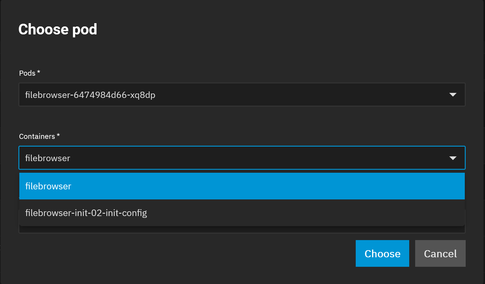

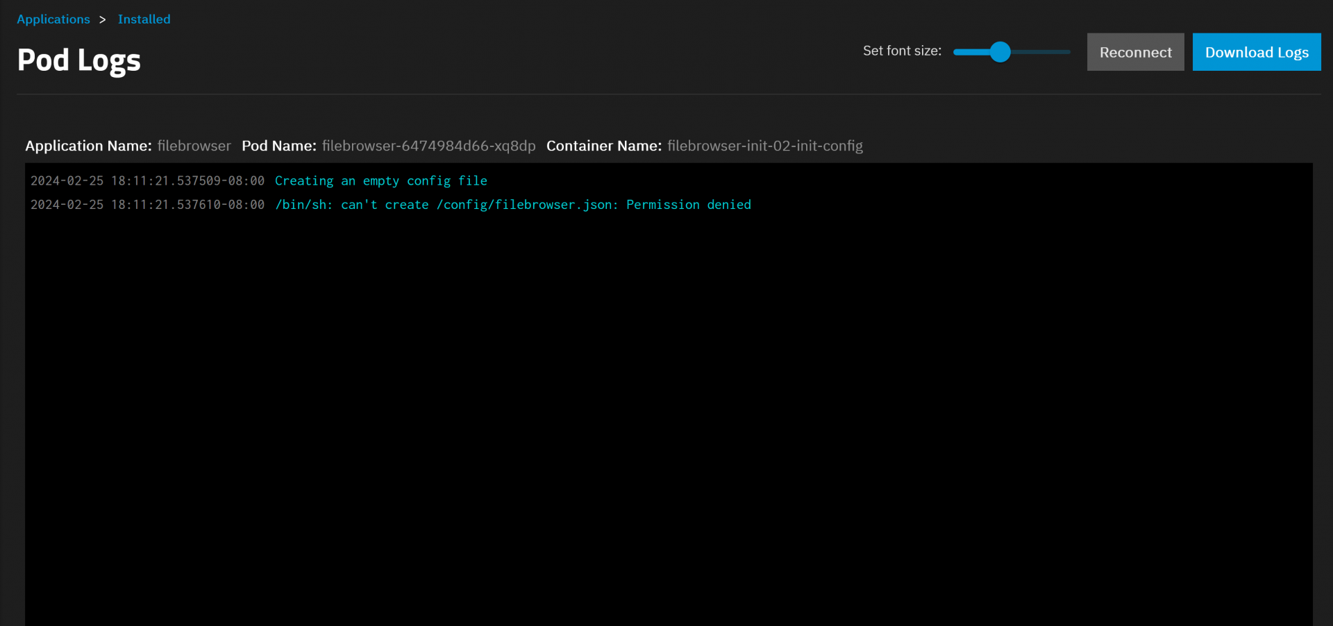

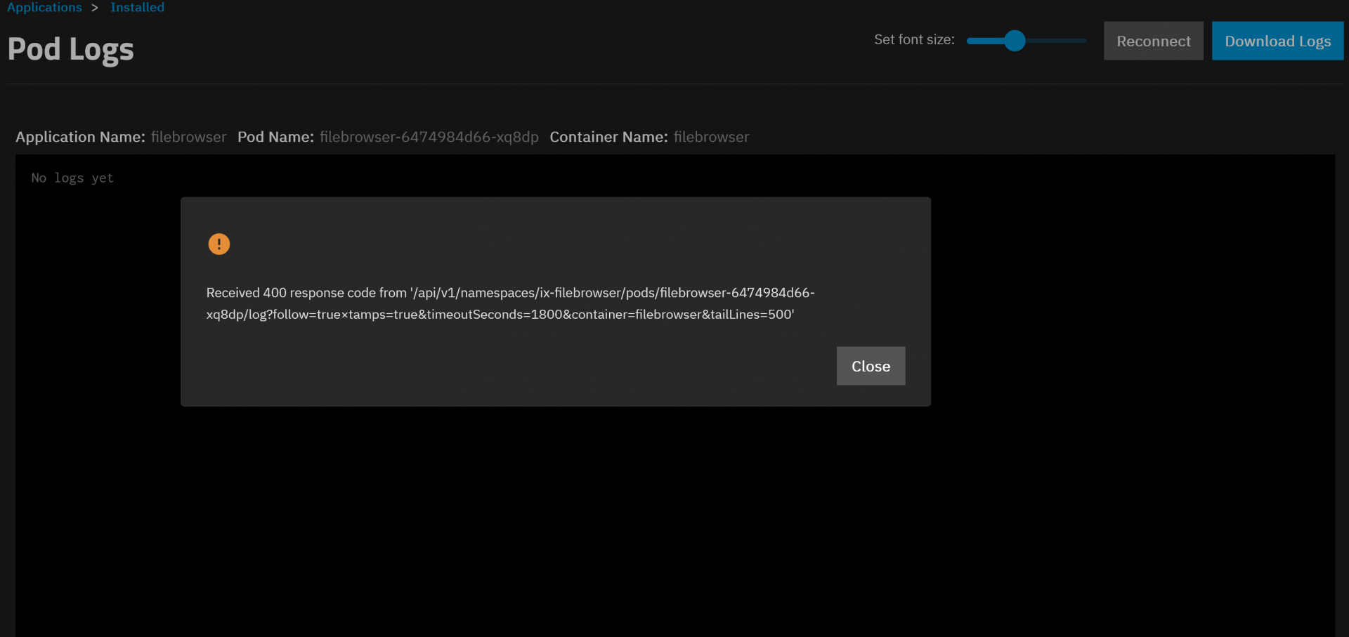

Whoops, I thought I attached those as well. I'm not too familiar with logs yet on understanding them fully, but I'm guessing it's something to do with permissions with with Data set i created? Also I'm using the TrueNAS app, not TrueCharts.

sfatula
Jul 5, 2022
608
Yep, permissions issue, sort that out and it will likely work
