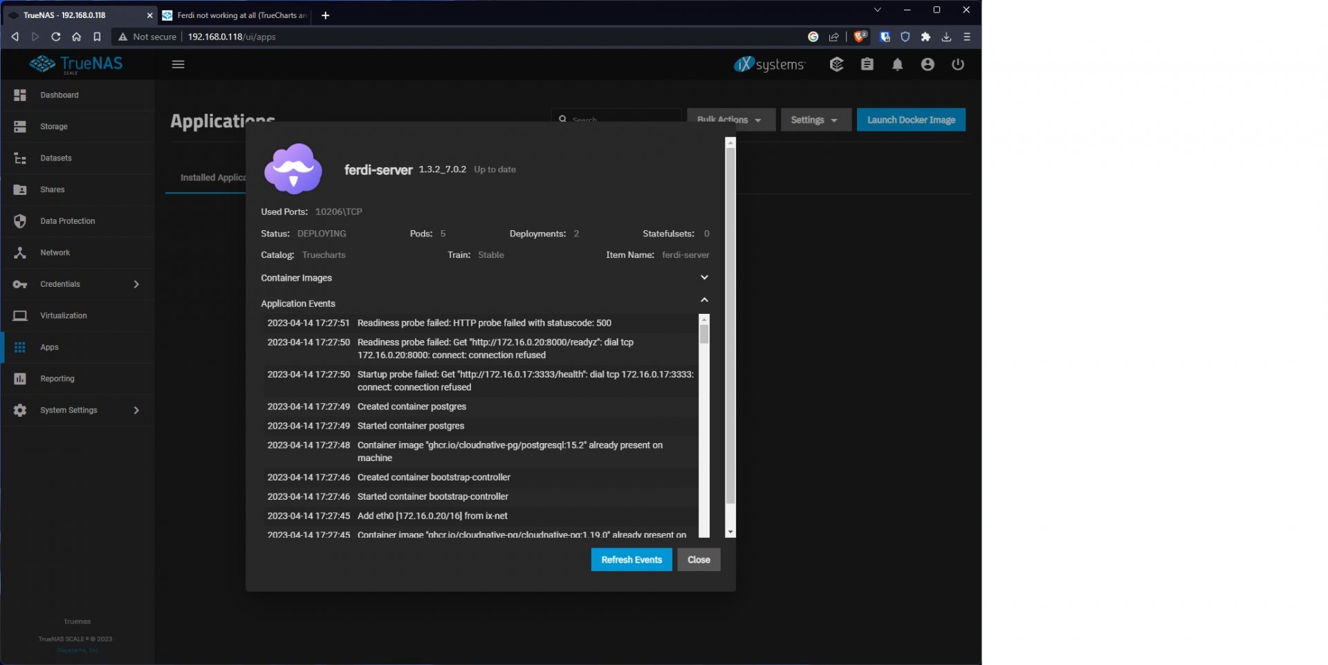

I setup now a brand new TrueNAS Scale in a VM.
Made a new pool
Installed ferdi-server and only the APP_URL the rest is default.
EXACT the same issue!
So I assume kubernetes is the issue?!
2023-04-14 17:27:51
Readiness probe failed: HTTP probe failed with statuscode: 500
2023-04-14 17:27:50
Readiness probe failed: Get "http://172.16.0.20:8000/readyz": dial tcp 172.16.0.20:8000: connect: connection refused
2023-04-14 17:27:50
Startup probe failed: Get "http://172.16.0.17:3333/health": dial tcp 172.16.0.17:3333: connect: connection refused
