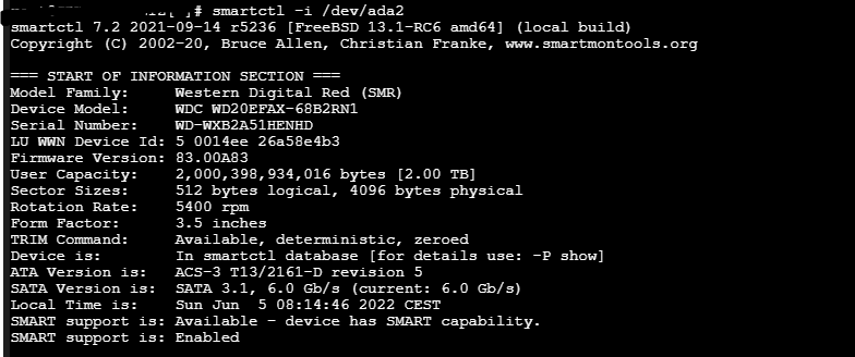

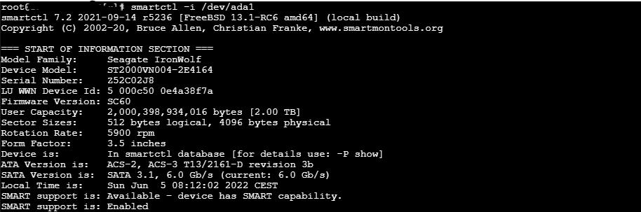

The result for ada1 new disk I try to attach
Result for ada2 old disk with datas

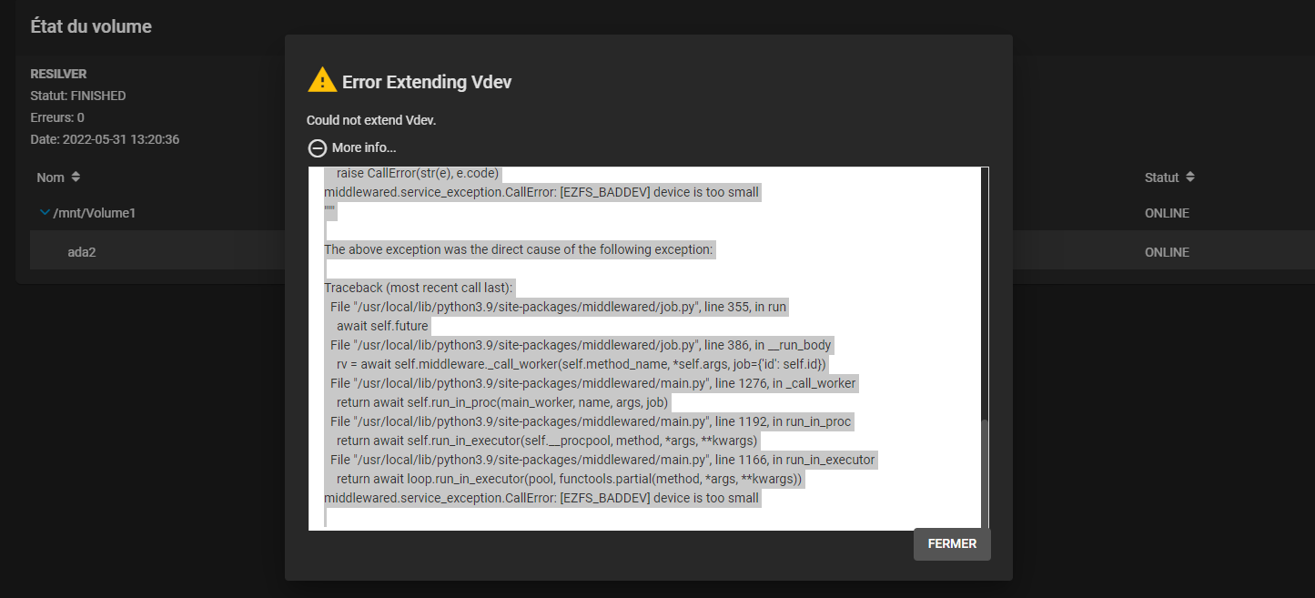

When i try to extend Vdev Volume1 I get this
Erreur: Traceback (most recent call last):
  File "/usr/local/lib/python3.9/site-packages/middlewared/job.py", line 355, in run
    await self.future
  File "/usr/local/lib/python3.9/site-packages/middlewared/job.py", line 391, in __run_body
  File "/usr/local/lib/python3.9/site-packages/middlewared/schema.py", line 975, in nf
  File "/usr/local/lib/python3.9/site-packages/middlewared/plugins/pool_/attach_disk.py", line 86, in attach
    await job.wrap(extend_job)
  File "/usr/local/lib/python3.9/site-packages/middlewared/job.py", line 484, in wrap
    raise CallError(subjob.exception)
middlewared.service_exception.CallError: [EFAULT] concurrent.futures.process._RemoteTraceback:
  File "/usr/local/lib/python3.9/site-packages/middlewared/plugins/zfs.py", line 212, in extend
    i['target'].attach(newvdev)
  File "libzfs.pyx", line 392, in libzfs.ZFS.__exit__
  File "libzfs.pyx", line 2092, in libzfs.ZFSVdev.attach
libzfs.ZFSException: device is too small
  File "/usr/local/lib/python3.9/concurrent/futures/process.py", line 243, in _process_worker
    r = call_item.fn(*call_item.args, **call_item.kwargs)
  File "/usr/local/lib/python3.9/site-packages/middlewared/worker.py", line 111, in main_worker
    res = MIDDLEWARE._run(*call_args)
  File "/usr/local/lib/python3.9/site-packages/middlewared/worker.py", line 45, in _run
    return self._call(name, serviceobj, methodobj, args, job=job)
  File "/usr/local/lib/python3.9/site-packages/middlewared/worker.py", line 39, in _call
    return methodobj(*params)
  File "/usr/local/lib/python3.9/site-packages/middlewared/schema.py", line 979, in nf
    return f(*args, **kwargs)
  File "/usr/local/lib/python3.9/site-packages/middlewared/plugins/zfs.py", line 215, in extend
    raise CallError(str(e), e.code)
middlewared.service_exception.CallError: [EZFS_BADDEV] device is too small
The above exception was the direct cause of the following exception:
    await self.future
  File "/usr/local/lib/python3.9/site-packages/middlewared/job.py", line 386, in __run_body
    rv = await self.middleware._call_worker(self.method_name, *self.args, job={'id': self.id})
  File "/usr/local/lib/python3.9/site-packages/middlewared/main.py", line 1276, in _call_worker
    return await self.run_in_proc(main_worker, name, args, job)
  File "/usr/local/lib/python3.9/site-packages/middlewared/main.py", line 1192, in run_in_proc
    return await self.run_in_executor(self.__procpool, method, *args, **kwargs)
  File "/usr/local/lib/python3.9/site-packages/middlewared/main.py", line 1166, in run_in_executor

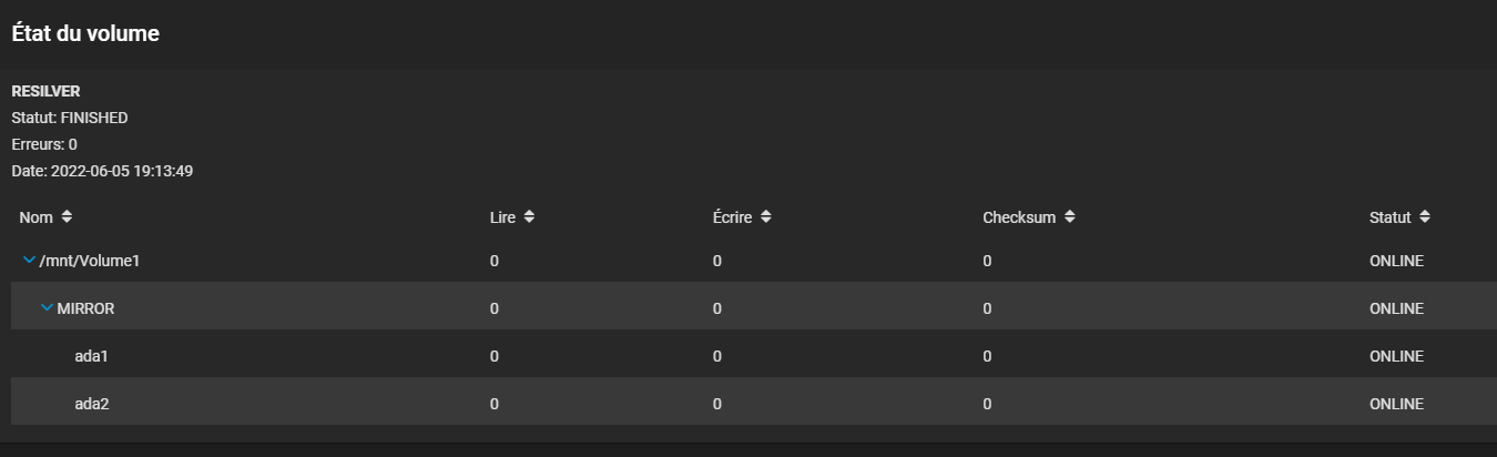

mirror fully "on line" with 2 new disks Seagate ironwolf , resilvered from the previous WD RED disk that was always working but now detached.
Problem fixed , thanks you all for your advices.
