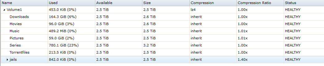

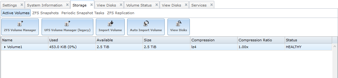

I am currently using around 945 GiB. I am snapshotting one of my datasets (photos, 59GiB) regularly but it doesn't change so that wouldn't really make a dent. Now that I'm closely looking at the active volumes tab in my FreeNAS, I can't make anything of it. What's 'available' and 'size' and why can it differ throughout essentially one volume?

I'm confused. You have 945GiB used. You are showing 2.5TiB available. That is approximately 3.45TiB. A pool of 3 x 2TB works out to about 3.5TiB of space, give or take a little. Those numbers are essentially identical. There's no problem here.

Well there's at least one problem and that's my noobyness. Otherwise, there probably isn't. I'm just wondering why the gui doesn't show an estimated 'grand total' of space in my volume (available+used, so in this case 3.5 TiB). It only shows 'Available' (2.5TiB) and an illustrious 'Size' which I can't really place and varies within my volume from 2.5 TiB to 3.2TiB.
15,504
It has to do with how ZFS views the size, which I don't fully understand, but in many ways datasets are treated as separate volumes. This could stand to be quite a bit clearer in the GUI (it's just reporting what zfs list says), but I understand it would take quite a bit of work to accomplish that.

18,680
The size is effectively the amount used plus the amount free. This should make sense.
Where it gets confusing is that the available space may be available to multiple datasets. But it could also be reserved or quota'ed or other various things, in which case the space that is reported as free would be different.
It's not peculiar, it's just complicated and not immediately obvious. Once you see it for what it is saying, it is straightforward.
