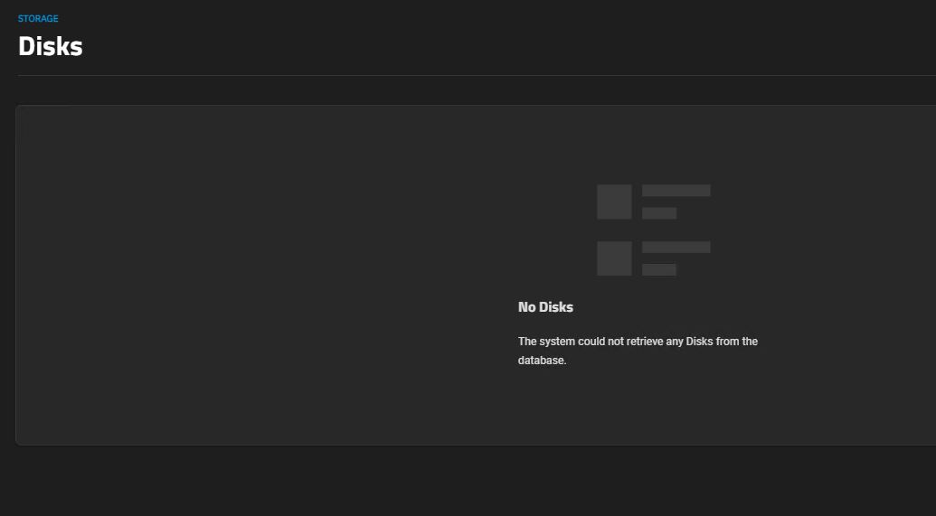

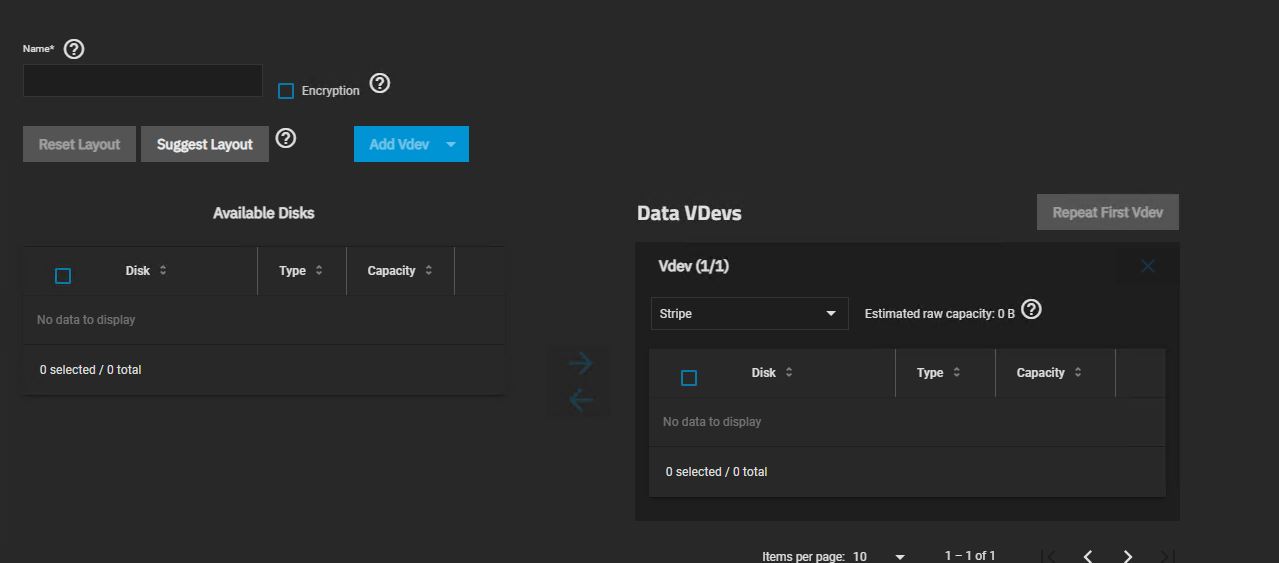

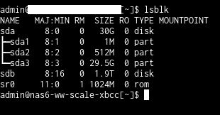

Hi, Clean installed latest TrueNAS SCALE 22.12.2 on HP DL380 G7 + P410i RAID Mode with two logical disk (30G + 2T), OS installed on logical disk 0 is ok and detected both disk during install, after success to install but no disk found and unable to create pool in the Web GUI, but run lsblk in CLI is shown the both disk and able to format the logical disk 1, but same machine was installed TrueNAS Core for long time is no problem, how to let the scale to detect the logical disk 1 in GUI ?

Stop using a RAID controller. Use an HBA
9,700
You need to read this:
NugentS
Apr 16, 2020
2,947
Either flash the P410i to IT mode (if you even can) or take it out and replace with an HBA.
My google fu says it needs to be replaced. Apparently you can load a specific firmware and then run in a broken HBA Mode but given the article also mentions kernal patches to use this I am dubious.
Get an HP220 card as a suitable alternative
Arwen
May 17, 2014
3,611
but the P410i unable to change to HBA mode and supported in Core, unable to detect in Scale is normal ?
Having the P410i sort of working in TrueNAS Core does not make it a good idea. You were on thin ice and the ice had not broken yet. ZFS is not suitable with consumer level hardware RAID, simple as that. It may work, until it does not work. In which case, you may have to restore your data from backups.
To be clear, FreeBSD, (which TrueNAS Core is based on), may have built in support for the P410i, so it sort of worked. But, it is not suitable for ZFS.
That said, if you have good backups and want to run it, go ahead. It simply is not supported by TrueNAS, Core or SCALE.
